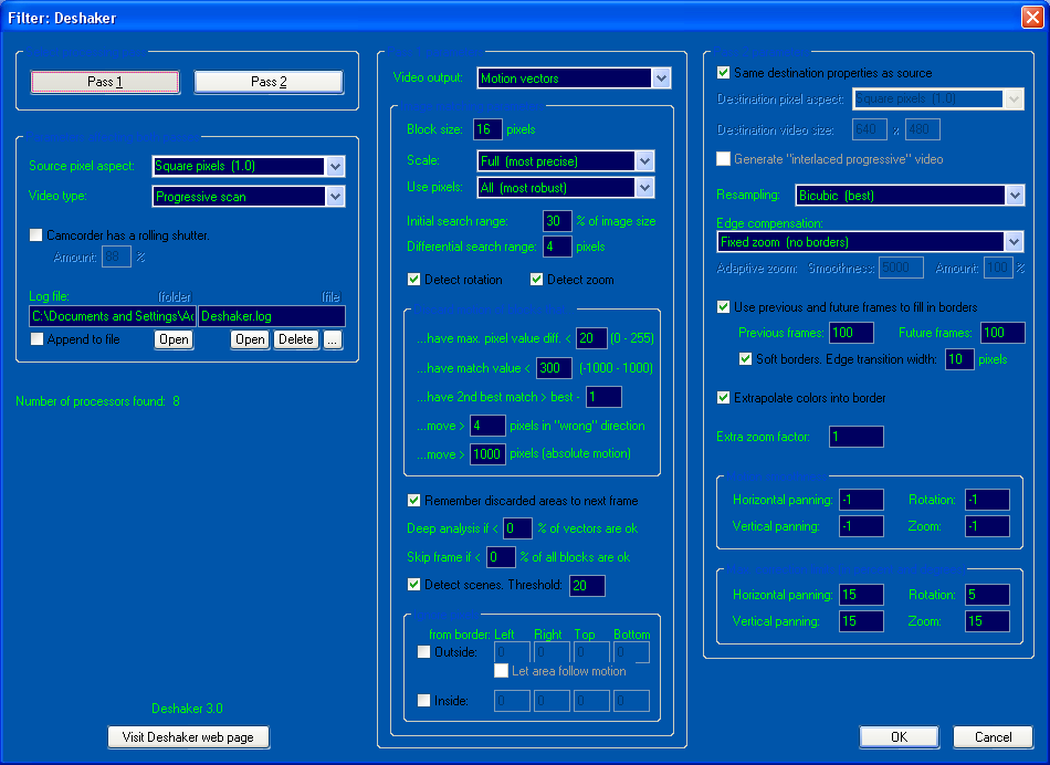

  5. My stab output doesn't have jerk but it does have wobbling only noticeable when you increase the framerate to 60, it doesn't look at frames in the long term like Deshaker. What I wish I could get deshaker to do is have 100% smoothness with the zoom like it does with panning. Your deshaked output didn't have long-term zoom but it still had smoothed shaking. My settings:
