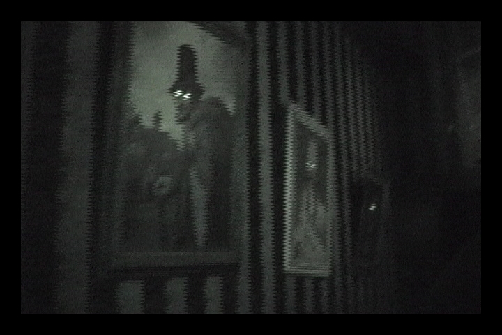

    I have this 16:9 video shot with a Digital8 cam. For some reason it has a 30 pixel border around it. It was shot years ago and has been sitting on an archive hard drive and I have no recollection of how or why it got that way. It definitely didn't come out of the camera that way. What I want to do is get rid of the border and end up with properly sized, properly interlaced 16:9 720x480 video in as few steps as possible. I find that just cropping 30 pixels off all around screws up the interlacing and I end up with a mess.
    What do you suggest?
    Thanks for all input.

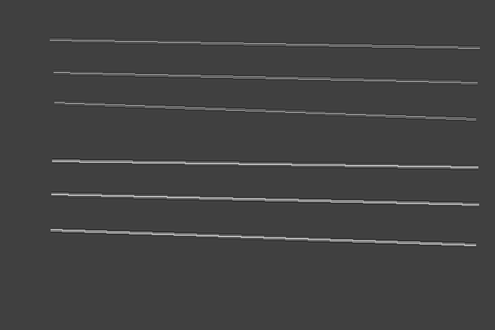

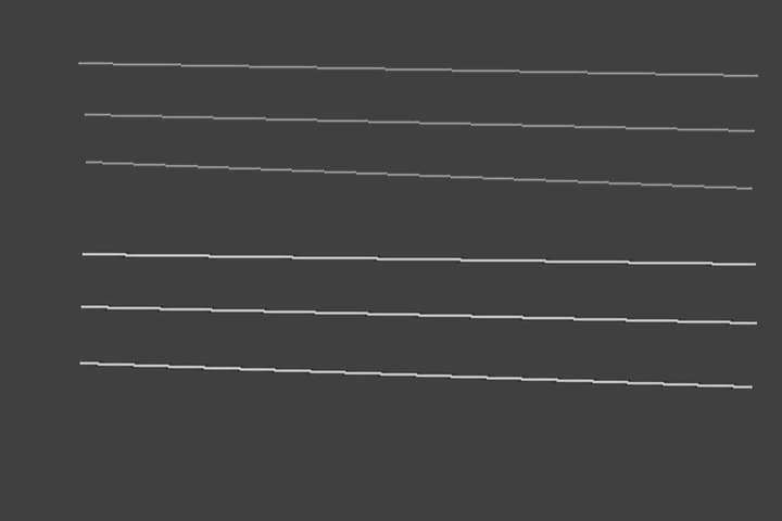

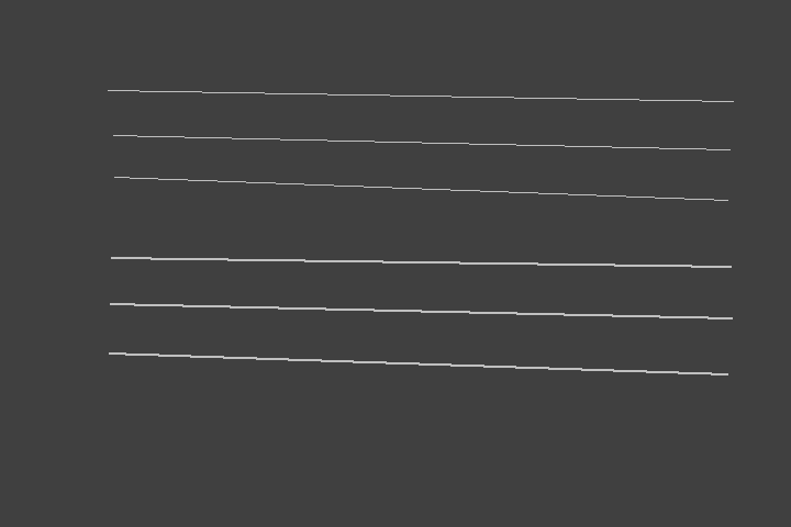

    You see the problem easily using sharp horizontal edges or lines.
    I can't seem to embed images?
    orig.png is the source image:
    sep.png:
    crop(32,32,-32,-32)
    separatefields()
    lanczosresize(720,240)
    weave()
    qtgmc.png:
    crop(32,32,-32,-32)
    QTGMC()
    lanczosresize(720,480)
    separatefields()
    selectevery(4,0,3)
