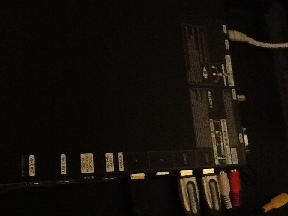

    Never heard of that adapter but I'm eager to try anything that might work, so I've included an image of the back panel on my TV (hope I did it right). Maybe that can help somewhat with the diagnosis, so to speak? The red & white connectors are in the wrong spot, that's just the last place I left them when I last tried messing around with it. They should actually be to the left of the thick gray cord.
    I've pinched the metal to make it stay but it does not do much difference. Thanks for trying though. I wish it had worked.

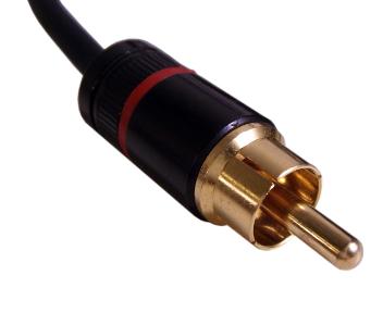

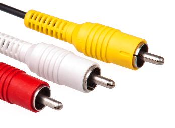

    There's one other possibility: I can't tell for sure looking at your picture, but sometimes the plastic shielding around the cable connector prevents it from seating all the way into the socket on the TV. If that's the case you can cut away some of the plastic. Or just get new cables without the plastic shielding over the metal parts of the connector.
    plastic shielded:
    Unshielded:

    We still do not know exactly what kind of connection is on the back of that TV.....nor do we know the make and model of the TV.
    No information? - no help. You get guesses.....not answers. Put up a better picture or tell us the make and model # of the TV so we can look it up online. You could be sticking those RCA cables into an AUDIO OUT connection for all we know.

  17. Sorry I did not realize that was necessary. I figured all smart TVs are pretty much the same. My bad! Not exactly a high tech person (hence coming here).
    It's made by Samsung and the model # is UN55D6000SF (if you take out the 'SF' from the end it says that is the 'type' number as well, not sure if that's important). I just took a flashlight to the back of it to get that but there were other numbers there as well so if I got the wrong one I'll try posting others
