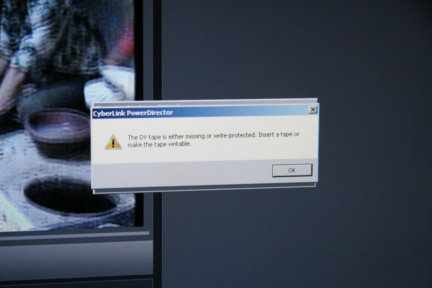

    I seem to have problems capturing VHS footage on my Laptop, I'm using PowerDirector 11 and i want to capture raw footage
    I keep getting this message even thought im using the camcorder as a pass-thru
    Can someone help thanks

    Worth giving WinDV a shot instead.
    It sounds like you hit the wrong button and the software thinks you're trying to record to the device rather than capture from it, though.

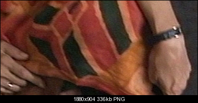

    BTW, this is the artifact we're all talking about, right? To me it looks like TV aerial transmission interference rather than what I would describe as dot crawl. Of course, he said his wedding video shows it too...
ID:	23124Click image for larger version

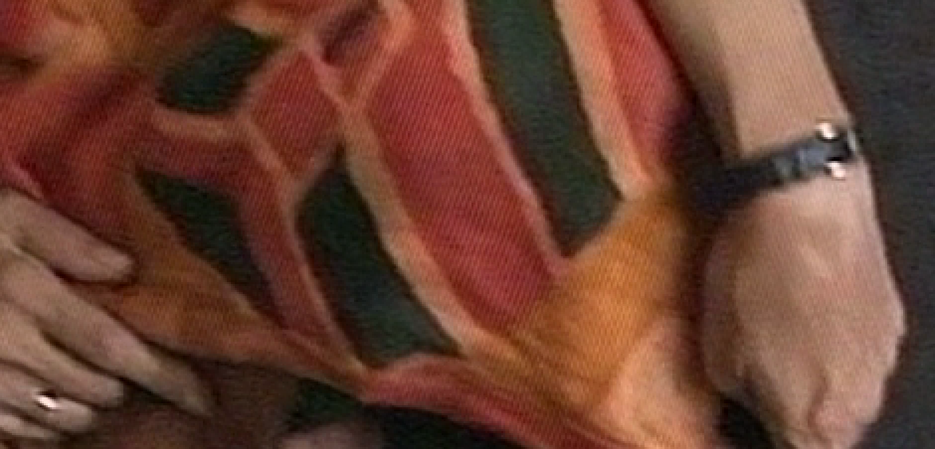

    Just got a Belkin Pure AV cable just this morning (£5.95) and tryed the same clip as before with this cable
    New Clip
  20. Formerly 'vaporeon800' Brad's Avatar
    Apr 2001
    Vancouver, Canada
    Did you change any camera or VCR settings? The new capture has a lot of chroma noise, not present in the first one...
  21. It's also sharper, more saturated, has worse over sharpening halos, more luma noise, and the opposite field order. But the chroma/luma crosstalk has gone away!
