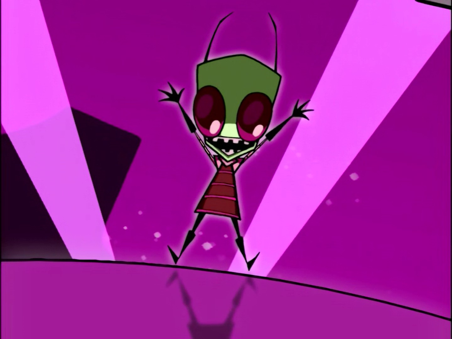

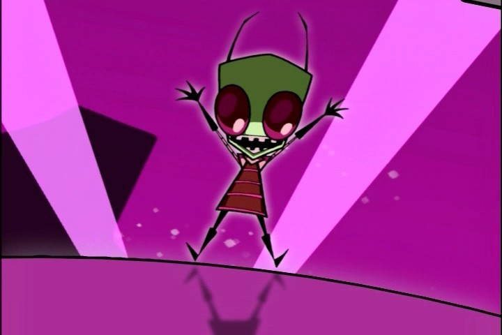

  5. How about this 4:3 DVD frame:
    Upscaled to 1440x1080:
    That was done with nnedi3_rpow2() and a few other filters. Oh sorry, the colors are different because I forgot to use rec.709 to make the upscaled jpg file (I just opened the encoded video with VirtualDub and exported from there).

    On the upscaled image, I see smoothing. In this case, the upscale became better than the original. But the color palette is limited. What about a 480 still from a DVD?
  8. Originally Posted by budwzr View Post
    That was a 480 still from a DVD and the same frame from the upscaled h.264 video.
