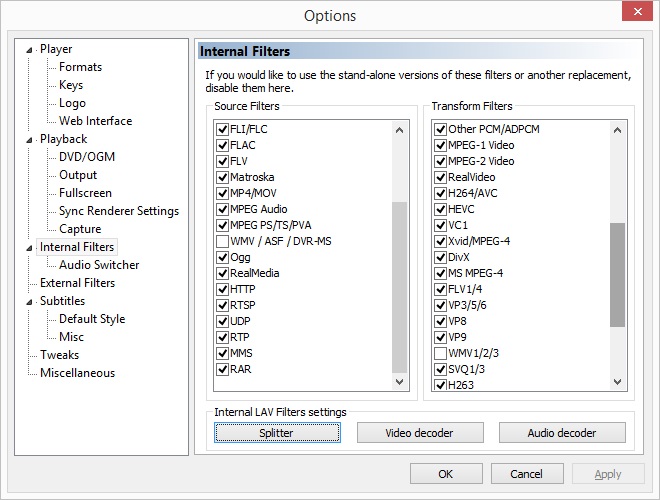

  17. Yes you can configure the internal or external filters . "Internal" means not system installed in this case, and internal to MPCHC
    Right click , Options => Internal Filters => Under Source Filters, make sure MOV is checkmarked . Under transform filters, h.264 should already be enabled (h.264 because mediainfo says your MOV uses h.264)
  18. I have an MP4/MOV Source Filters entry that is checked and an H264/AVC Transform Filters entry that is checked. I assume these are the correct entries. I'll attach a snapshot.
    My previous post may not have been precise enough. The player opens and says it is playing but nothing ever renders and the progress bar never moves. I played with the buttons a bit (guerrilla style) with no change. So perhaps the problem is related to these MOVs not being quite customary.

  21. It's no problem at all . I was only asking about the mov as a "plan b" , but unlike the report for the wmv, nothing in the mediainfo for the mov suggests anything abnormal
