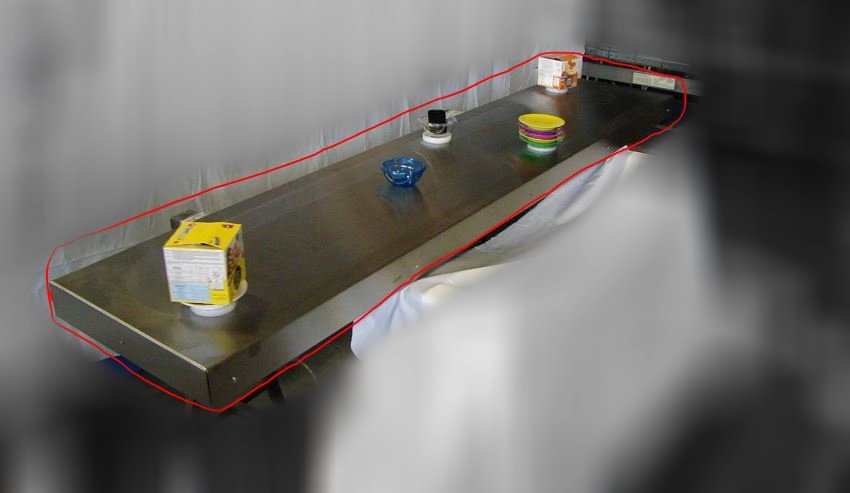

    I have a video with a fixed shot, it is a kind of table with a kind of track that moves in a circle some items.
    I would like to "cut out" and blur everything that is outside of the table (outside the red zone)
    I enclose a picture of similar example to understand

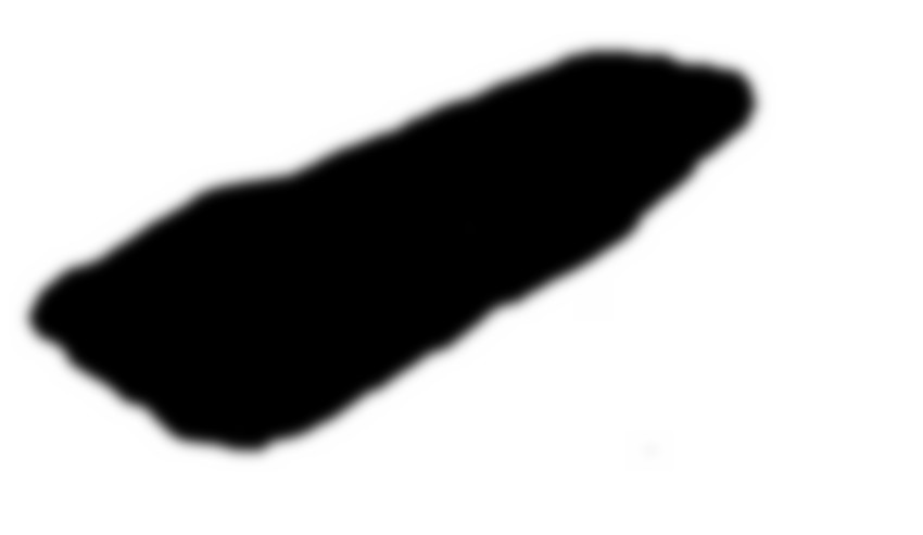

  3. Something like this?
    A=ImageSource("Table.bmp")
    B=A.AverageBlur(50)
    Mask=ImageSource("Table1.bmp")
    Overlay(A,B,0,0,Mask)

    Jan 2014
    Italy
    B=A.AverageBlur(50)
    Hi and thank you,
    Yes, I need something like you've show, but applied on my film and not on a single picture: how I get this?
  5. Originally Posted by reggio View Post
    The same way, just using the proper videosource rather than ImageSource. For example:
    A=AVISource("video.avi")
    B=A.AverageBlur(50)
    The source filter you use might depend on the kind of video it is. Doing it like that the blur will last as long as the video. AverageBlur is part of the VariableBlur filter.
