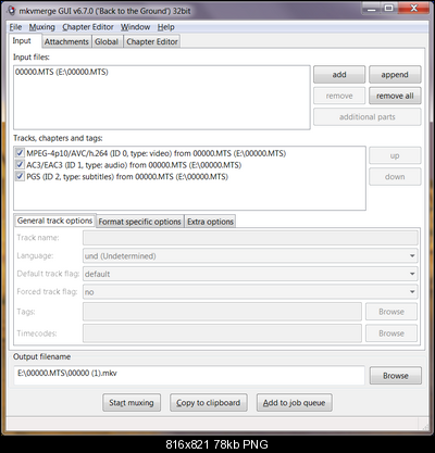

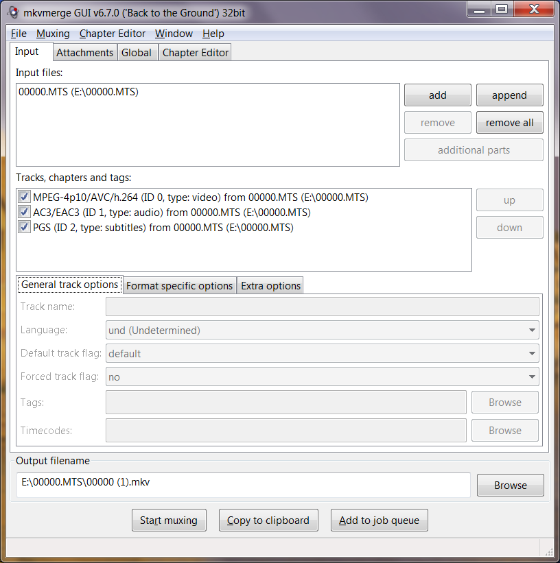

  10. Did you try with mkvmerge GUI?

  12. Yes, mkvmerge works with AVCHD files to copy the date/time subs . It diplays ok in various media players
    I don't know a way to get ffmpeg to work with them natively, unless you convert to srt first
