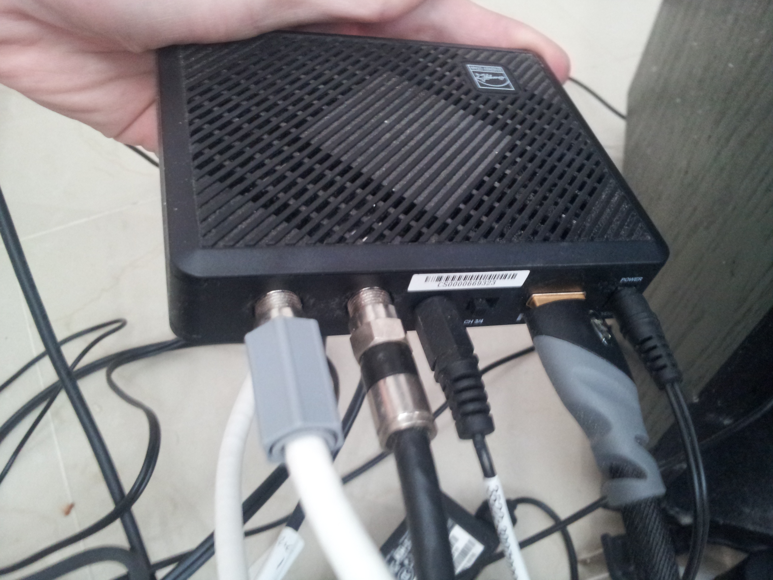

    The Cable Adapter

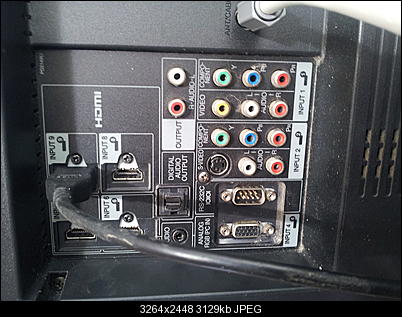

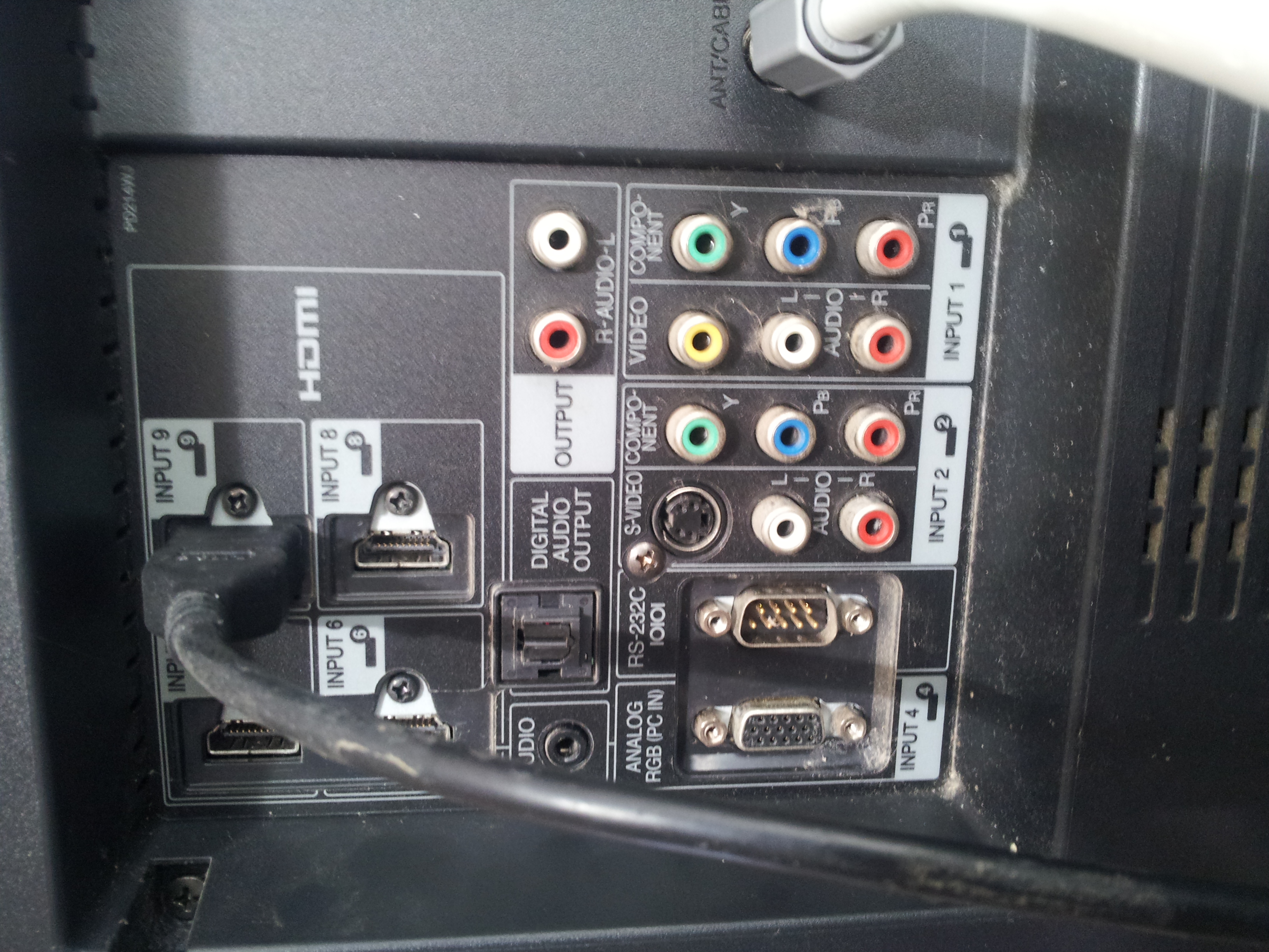

    The TV

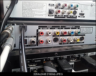

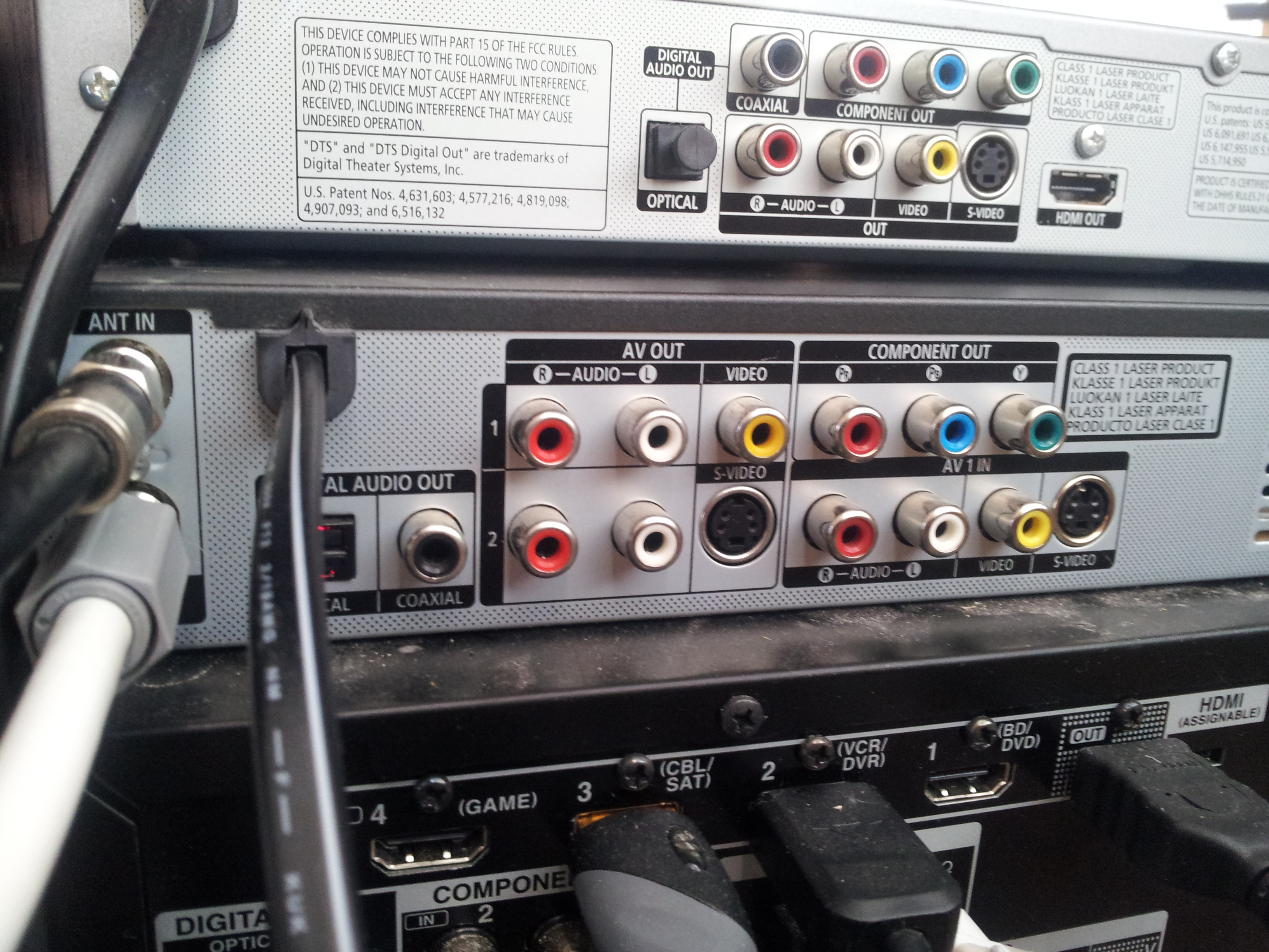

    The Recorder

    Those little cable adapters supply output on channel 3 or 4 similar to what a VCR does when playing a tape. Did you try setting the DVD recorder's tuner to channel 3 or 4?

    I did set the input to correct one...

    try changing the black /white cables around. it looks like you have those hooked up wrong

    Yes, check your RF coax connections. It is easy to make a mistake because the labels on the adapter's RF connection are frequently not easy to read.
    These are the relevant steps, and how I have one of my own DVD recorders connected to a cable box:
    1. Connect the coax cable from the wall to the cable adapter's RF in.
    2. Connect the cable adapter's RF out to the DVD recorder's RF in.
    3. Connect the DVD recorder S-Video or composite video out, plus stereo audio out to corresponding inputs on TV. (Note that the DVD recorder's RF out is a pass through. This means the RF out from the DVD recorder will only supply an analog A/V video signal on channel 3 or 4 since that is all it is receiving. Do not connect the DVD recorder's RF out to anything at this point.)
    4. Turn on the cable adapter, DVD recorder and TV
    5. Set the TV's input to the set you are using for the DVD recorder's output.
    6. Set DVD recorder's tuner to channel 3 or 4, depending on what the adapter output is set to.

    The black cable is coming from the wall, and the white is going to the tv, it says "to tv" for where the white cable is. Thanks usually_quiet ill foll;ow the steps
  8. usually_quiet very detailed answer, thanks.
