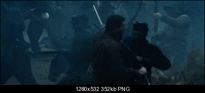

  1. I have problem with picture, i use virtualdub from XviD4PSP 5 apps and xvid video codec, i encoding 1st pass and 2nd pass , i have installed: ffshow, avisynth, K-lite codec, matroska pack, haali media splliter
    the picture is like this, what it wrong or what missing on my computer?

    Bitrate too low ? Try setting the Xvid encoder to do one pass, CQ = 3.

    Also, select MPEG quantization type instead of H.263
  4. Also, select MPEG quantization type instead of H.263
    I have and bitrate is more than 2000kb/s

  6. i deleted k-lite codec and i'm encode only one pass but picture is not better
    Mar 2008
    One pass at a constant bitrate is always liable to give the poorest results if the bitrate is on the low side.
    Either try CQ encoding (if it's available), or 2-pass encoding.

  10. Originally Posted by Xload View Post
    That's too low for 1280x532 and fast action material. Do what davexnet suggested, use target quantizer mode at 3.

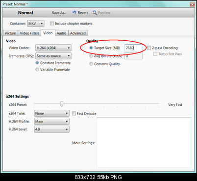

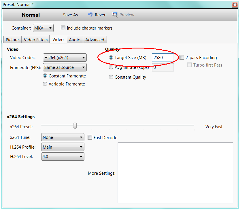

  19. As I write before: encode with VidCoder to mp4 or mkv
    press on Preview button to encode 1 min, to see quality example
    in Video tab set size:

  23. I am. Good program, I preview the output video file and the picture is great. Tomorrow I do encoding video file with H264 codec.
