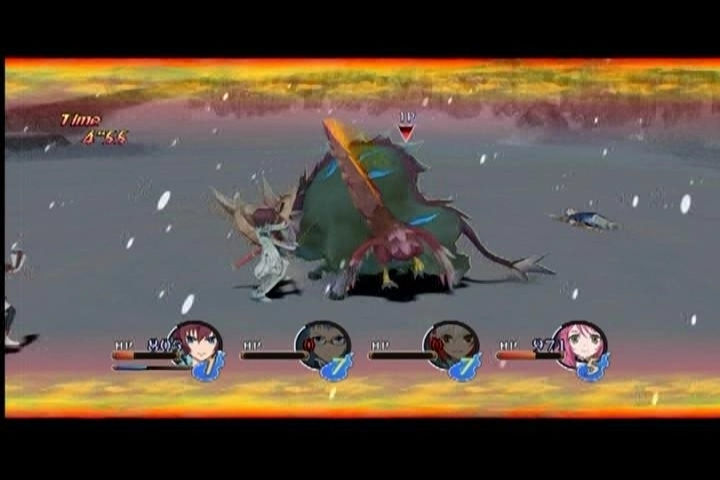

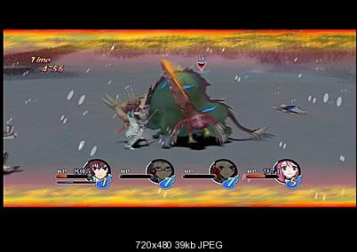

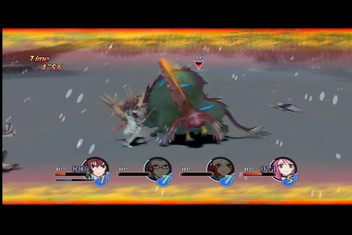

  1. I have been getting this weird flicker when i deinterlace my videos. I checked my source and it not there but after i deinterlace it is could i be qtgmc this just started happening out of nowhere and i dont know what is causing it. I thought my field oder was screwed up but after running the same video with it set to tff and bff and it still being there im just stumped i notice it around the numbers and letters on screen help me please .
  2. you should post an unprocessed sample of the source , and the script you are currently using
  3. Alrighty
    First pic is reencode 2nd pic is source
Name:	Tales reencode.jpg
ID:	22812Click image for larger version
Name:	Tales Source.jpg

    Im thinking it may be the left crop 20 but im not a video expert so idk.
  4. Originally Posted by ConanEdogawa View Post
    Not the crop ; because it's already been deinterlaced before the crop is applied, and the crop values are mod2 in YV12
    The status overlays of the "characters" are aliased (edges look all "jaggy") - that almost looks like a simple bob was applied, not QTGMC
    DirectShowSource() might be causing some of your issues, try replacing it with AVISource()
    If you still can't figure it out, upload an unprocessed sample of the source video
  5. The sharpness setting in QTGMC is pretty strong. It already does some sharpening by default and if I want to sharpen more afterwards I use something else (usually LSF). I'd try leaving it off and see if the aliasing improves. Maybe it's that aliasing that you're referring to as 'flicker'.
  6. My guess would be you have some filter applying a deinterlace in your directshow chain, before QTGMC even touches it

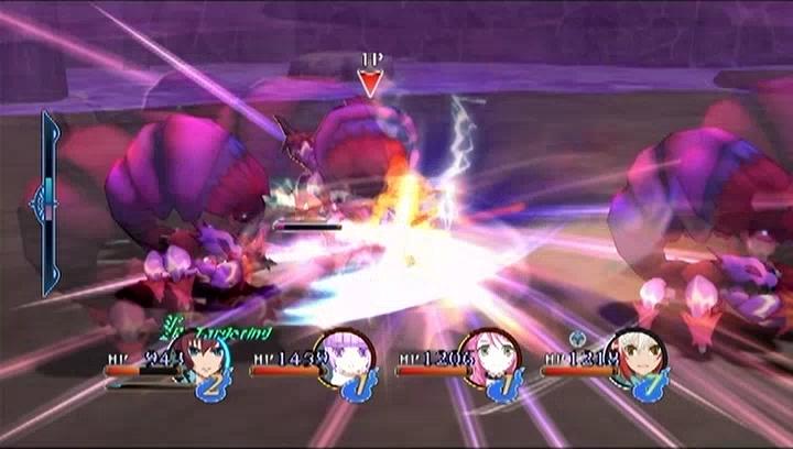

  7. Hmm so directshow could be the problem i will try switching to avi source sorry about that i didn't know you meant the actual source video.I did try it a few times with sharpness off still got the same thing any way here is the source video.
  8. QTGMC is just getting confused (and resorting to something like a simple bob) when the picture behind the text is changing a lot.
  9. It's actually a very good test clip .
    There are problem sections where every deinterlacer will fail or show problems. Each deinterlacer has strengths/weaknesses. There is no single deinterlacer that will work "best" here
    QTGMC will probably still produce "better results overall" . But in sections where it has problems you might replace or overlay sections with other deinterlacers with masks

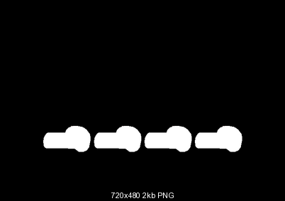

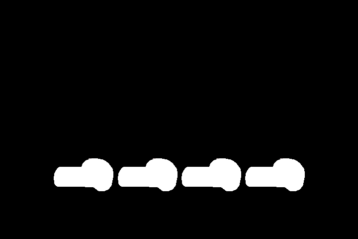

    Here's an example of using a mask:
    AviSource("Tales Source Clip.avi")
    AssumeTFF()
    ConvertToYV12(interlaced=true)
    mask = ImageSource("Tales Mask.png").ConvertToYV12(matrix="PC.601").Blur(1.0).Blur(1.0).Blur(1.0)
    v1=QTGMC()
    v2=Blur(0,1.0).Sharpen(0,0.7).SelectEvery(1,0,0) # fast blend deinteralce and sharpen
    Overlay(v1,v2,0,0,mask)
    Crop(20, 58, -0, -62)
    The mask:
    Substitute whatever alternate deinterlacer you want for v2. And you can make a more form-fitting mask.
    By the way, I think you need to set your MJPEG encoder interlaced mode.

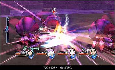

  15. FYI: a comparison with QuickSync and others
    by loading the sample clip into AviUtl, i managed to encode it with Q.Sync using internal deinterlacer.
    Another lesser-known deinterlacer, Automatic field shift, is also included here for reference.
