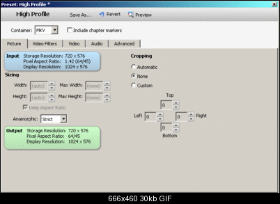

  3. Ripping and converting is often better as a 2 part process. Most free encoder GUI's won't rip copy protected DVDs. If you decrypt with something like AnyDVD though, many programs will open a DVD for conversion, and almost any encoder GUI should be able to create an anamorphic encode, even if they require you to rip the disc to your hard drive first.
    An anamorphic 720x576 encoding using Handbrake. No resizing. Automatic cropping disabled. The aspect ratio in this case is 4:3, but for 16:9 it'd just show a different "display size".

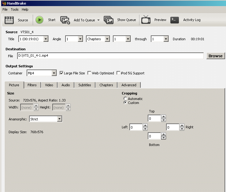

  10. Originally Posted by Jakob Olsen View Post
    In your example the resolution og the output filens 768x576 and the original is 720x576. Why isn't it the same and does this have any influenser of the quality?
    It's showing the actual resolution (720x576) and the display size, or display resolution, or display aspect ratio, whichever way you describe it. Handbrake shows it as "display size". For DVDs, the display size is always different to the resolution (anamorphic encoding). The picture is resized to the correct aspect ratio on playback, which would be 768x576 for 4:3.

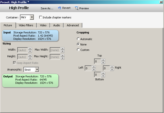

    It's a hard topic to explain (resizing DVDs), so instead here's a few examples which will probably explain it better, or at least explain how to do it without needing to think about it. Vidcoder instead of Handbrake, because Vidcoder lets you resize differently to Handbrake. If you resize to square pixels, I'd use Vidcoder.
    Anamorphic encoding
    Open a DVD (PAL 16:9 in this example). If cropping is set to none and anamorphic strict is used it should look exactly like this. The green "output" section shows it'll be encoded as 720x576 but on playback it'll display as 1024x576, just like the original DVD.

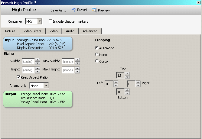

    Now enable cropping and (for this example) it's removing 12 pixels worth of black from the top and 10 from the bottom. It may also crop some from the sides, which is fine. Looking at the output section again you'll see the new storage resolution is 720x544 (22 pixels were removed from the height). The new display resolution is 1024x544. It's still anamorphic encoding, and the encode will be the same as the first example, only this time you're encoding just the picture instead of the picture with black bars.

    And finally, enable cropping again. Once again you're removing the black bars and encoding just the remaining picture. In this example it'll display as 1024x544 as it did when cropping was enabled for anamorphic encoding, but this time it's also encoded using a resolution of 1024x544.
