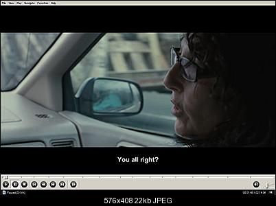

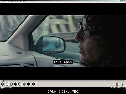

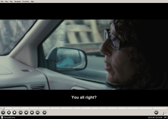

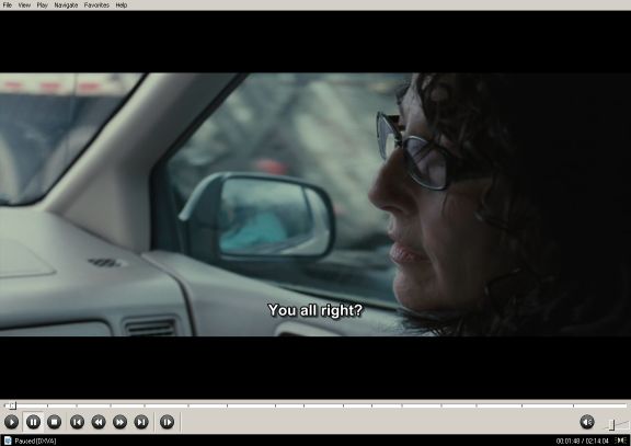

    Anyway..... MPC-HC has lots of subtitle options I've barely looked at and never used, but I went from loading subtitles as per picture 1 to loading them as per picture 2 and 3 pretty quickly. It took me a couple of minutes to realise the Play/Subtitles/Styles menu lets you change a subtitle style "on the fly" so changing it for a particular video doesn't change the default settings. I couldn't understand at first why changing the subtitle styles with that menu didn't seem to "stick" once the player was restarted.

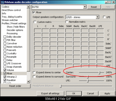

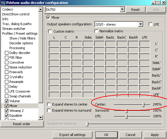

    VLC has some sort of audio compressor (I think), but that's one of the reasons I use ffdshow for audio decoding.... it can load winamp plugins and I use a winamp compressor plugin for late night viewing. And given most of the speech is in the centre channel, maybe not downmixing multi-channel audio to stereo when encoding might be an idea? You could mix it down to stereo on playback while giving the centre channel a boost.
    ffdshow can save it's configuration as presets and switching between them is easy.
