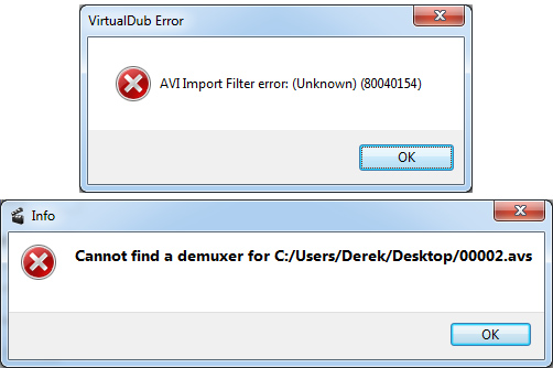

  17. But it looks like you are starting the commandline with "ffmpeg for..." , not "for..."
    That is where I messed up. I incorrectly assumed that I needed to have ffmpeg listed first. Before I saw your edit I just did the batch file, so ffmpeg is doing its thing now. It has output a couple of the smaller files, the frame rate is correct and decomb/decimate did well! These are some clips with poor lighting, I may run it again with the quantizer at 1.
    So did the avisynth method work for you ? Can you load the .avs in vdub ? post any error messages verbatim
    I still can't get avisynth working. I think the .avs is correct, but I must not have lav/ffdshow configured right. When using Win7DSFilterTweaker_5.9 I've tried setting both 32bit and 64bit to either lav or ffdshow for the decoder, but I still get the error. Although I don't plan on using avidemux to work with the avs, I know that it is capable of opening an avs, so I tried that as well. Attached an image with the error from both vdub and avidemux.
Name:	avs errors.jpg
  18. Are you using 32bit everything ? Avisynth 64bit is unstable / has lots of issues. That means 32bit avisynth, 32bit vdub, etc....
    Can you make a 1 line script
    version()
    save it, and open that .avs in vdub
  19. The one liner will not open either, same error. I didn't know the 64bit version was trouble, I'm going to have to go back and go 32bit everything. Will report back.
  20. 64bit OS is ok, just all applications in the avisynth chain have to be 32bit, or have some wave of handling 32bit => 64bit issue

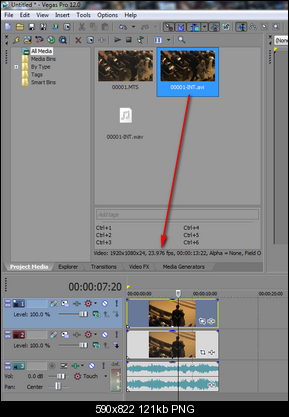

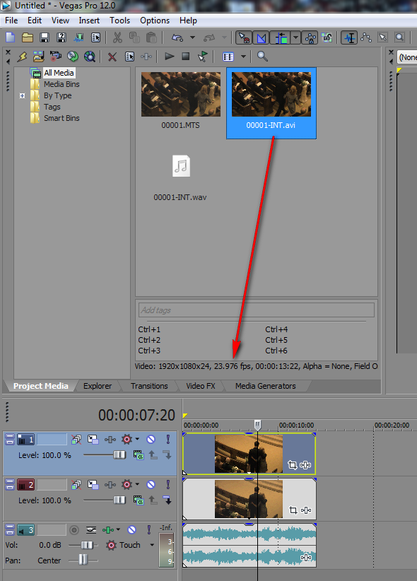

  22. aBigMeanie aedipuss's Avatar
    Oct 2005
    666th portal
    there is an old tool that will ivtc the 30i to an intermediate 24p that will edit in vegas pro fine.
    search for - Batch_32_Pulldown_Remover_v14
    install it and any of the other programs it needs if you don't already have them. install the UT codec. use the ut yuv420 bt709 compression.
    use the output intermediate 24p video and the audio from your original 30i. the wav the program file creates is always to short.
