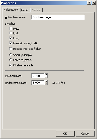

  11. Member racer-x's Avatar
    Mar 2003
    3rd Rock from the Sun
    I'm not sure how to do that though. Right now the file is set so that it plays fast, how do I, for starters, get this at the right speed? And then how do I set it to render with duplicates at 24 instead of blending?
    Open a new project in Vegas set at 1280x720 @ 24 fps. Import your mov clip into the timeline. Right-Click on Clip and select Properties. Make sure Disable Resample is ticked and set playback rate to 0.75 like shown below:
    When you click OK, you should see a squiggly line on the clip indicating it was time compressed. You'll need to stretch it back out to full length by dragging the right edge.......
