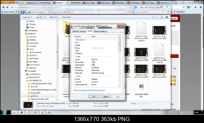

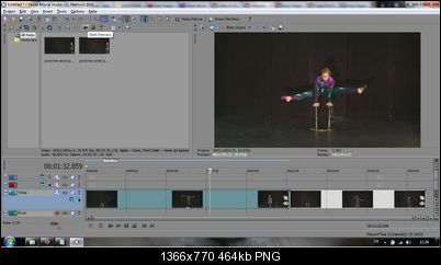

    What I have: video files that my friend supplied to me to create a demo video. Their properties are in pic below.
ID:	22680basically 1920x1080 29fps
    The final demo video is something that will be shared on youtube. something like 854x480.... not huge, just crisp and clean.
    The program I use to edit video is SONY VEGAS HD Platinum 10.0
    I've always done ok with basics in the past.

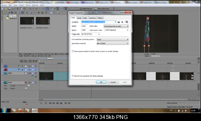

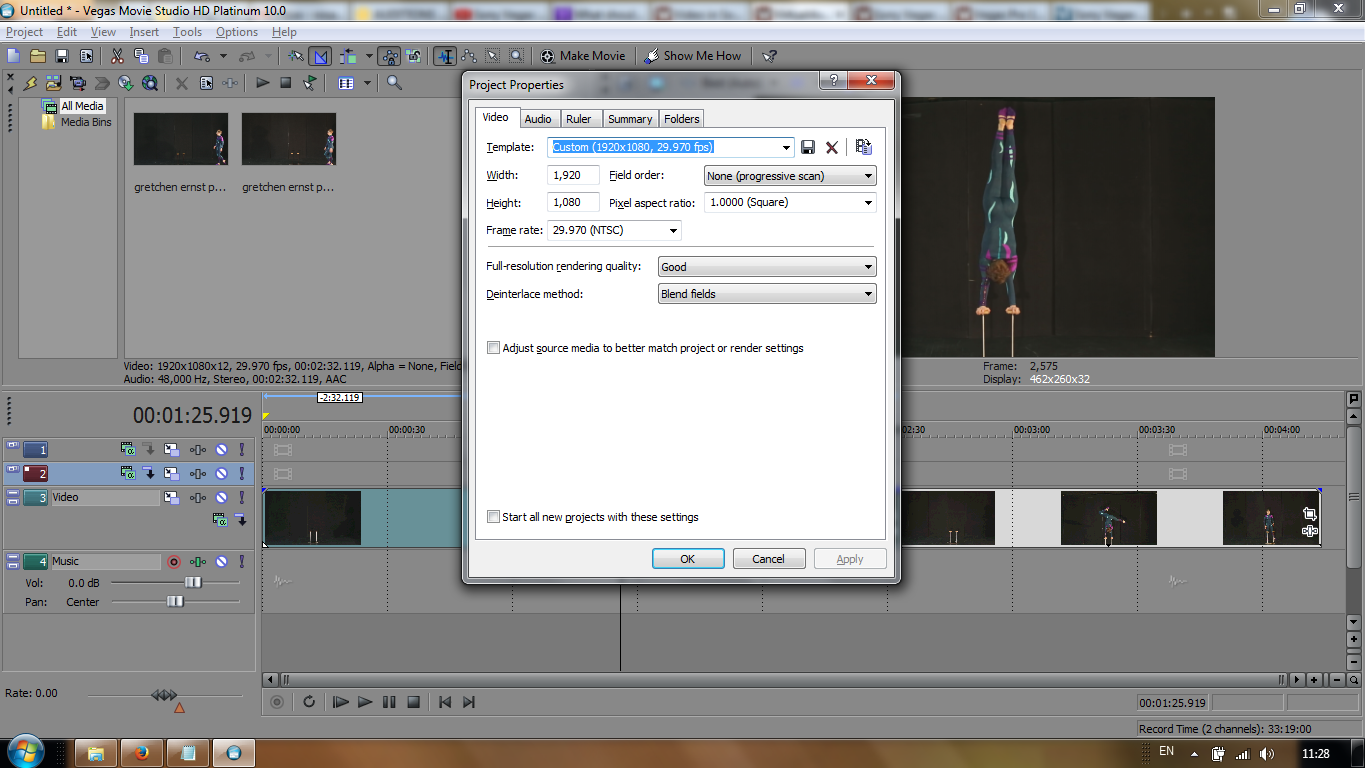

    I prepared the project settings to match the format of the imported files. see next picture.

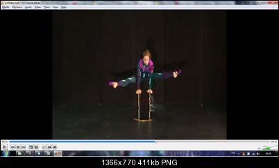

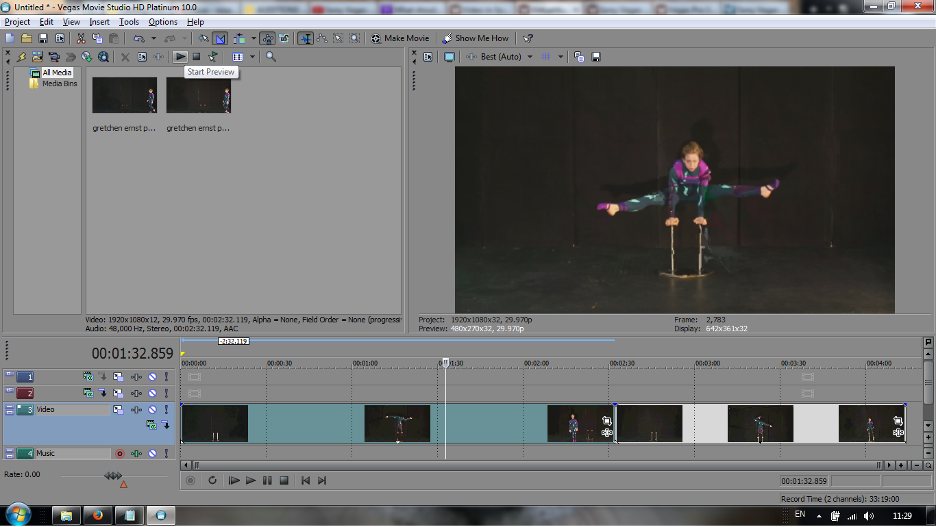

    no trouble "importing the media" - but as soon as i try to WATCH one of the files in the PREVIEW WINDOW, I can see the distortion shown in NEXT PICTURE. there are intermittent 'pixelizations' and choppy bits of light. specifically, in this frame, look at the cane on the right (below her left hand). there is a grey choppy area.
    so my problem is occurring BEFORE i even get to the render phase. the problem must be with the "import"? or the "project settings"?

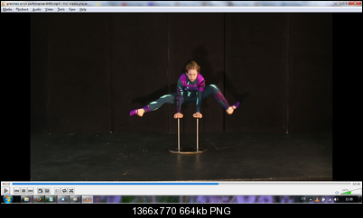

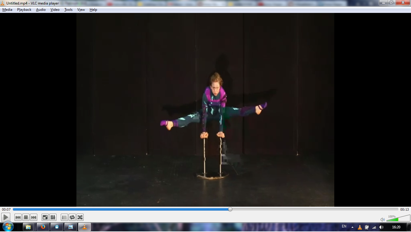

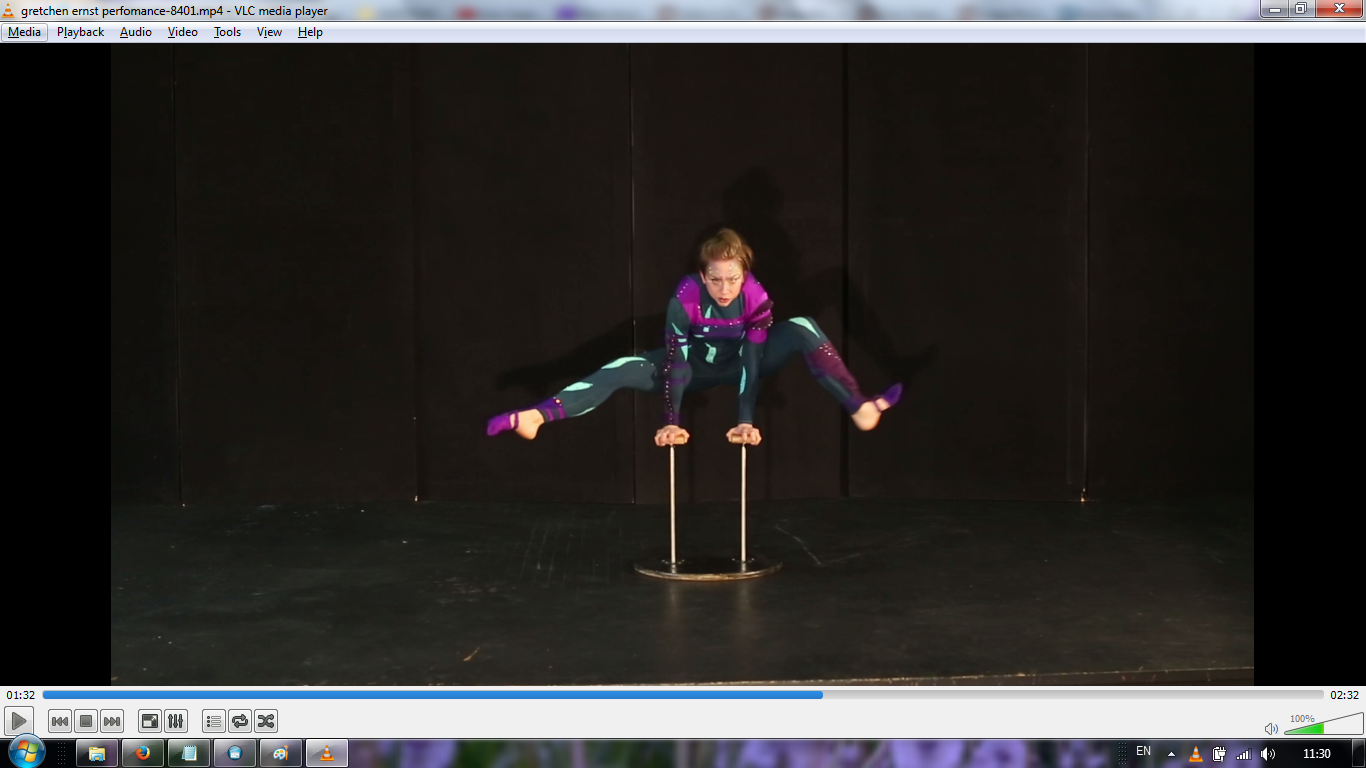

    this final picture shows the raw video as played in VLC - without the distortion. i know it isn't the exact same FRAME, but believe me, this demonstrates the "what i should see" versus "what is happening in Sony Vegas"

  2. but your preview is set to 480x270, ..., underneath your preview window you can see:
    Project: something
    Preview: something
    set it to Best Full, not Best Auto (above that preview window)
    but then your PC might not make it in time to render preview, depends on your processor .... or maybe it even barely handles that 480x270 ...

  8. Hi All, Thanks for your suggestions. I have carefully tried each one. No luck still: here is my report!
    FIRST: I am not able to select 29.0000 fps on the "project settings". when i "match media settings", 29.970 is selected and the drop down menu gives me 23-something and 25 as other choices. not 29.00
    off the bat, this seems like a problem - since 29.970 and 29.00 are not the same number in my experience. so why are my files with fps 29? is THIS the problem?
    SECOND: I made both changes to preview window (same as media settings - and 'best full') but this has not changed what i see. (pics below)

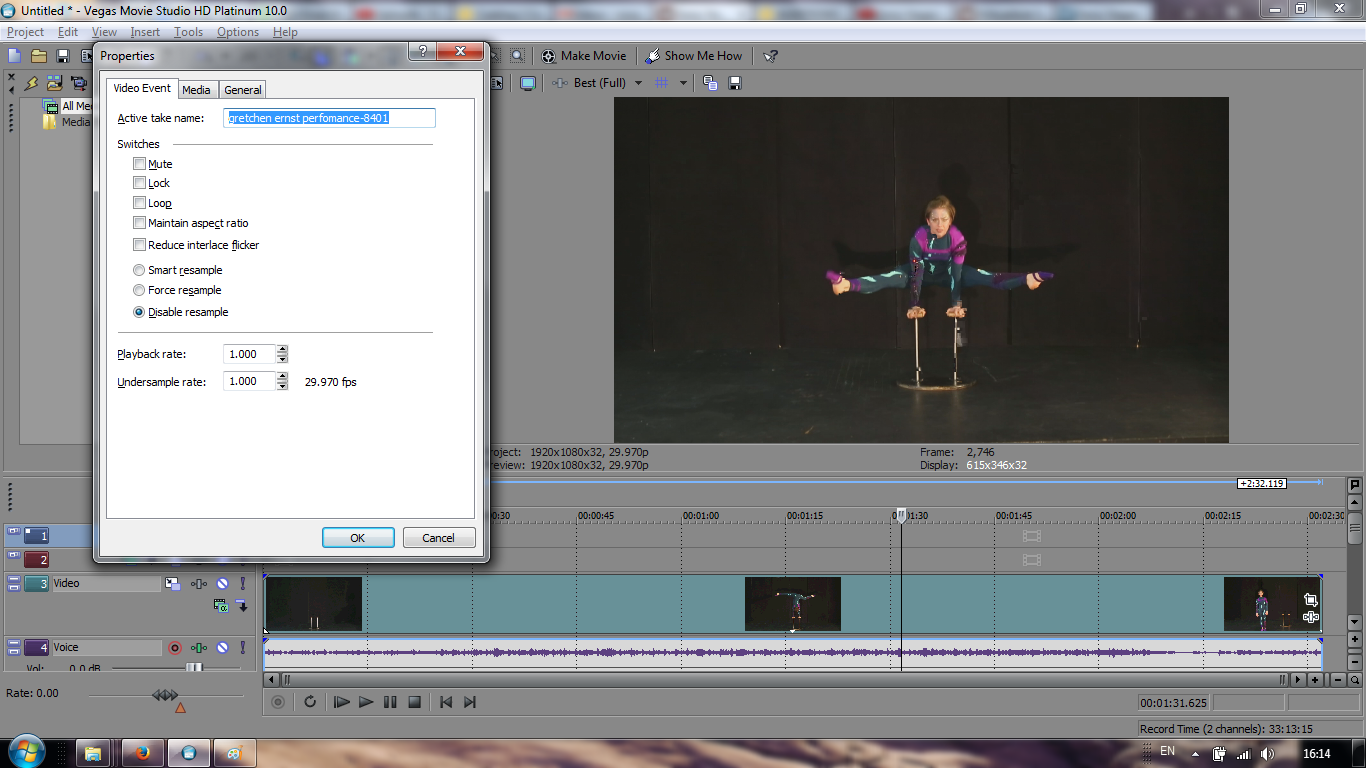

    THIRD: I did the disable resample - and i even tried under sampling to 29.011 fps but neither attempt (done separately of course) made any change (pics below)
    FOURTH: i copied a sample frame to the clipboard as suggested and even RENDERED a small section as a test. ALL demonstrate FAILURE.
    Pictures:
    as you can see, the project and preview is now the same on the low left of preview window
    set to best full above preview window

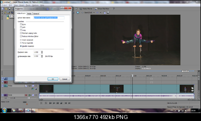

    disable resample (and i tried it both WITH maintain aspect ratio and without)

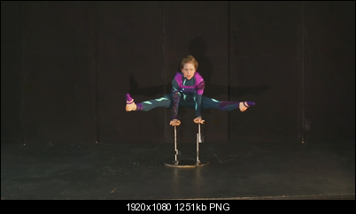

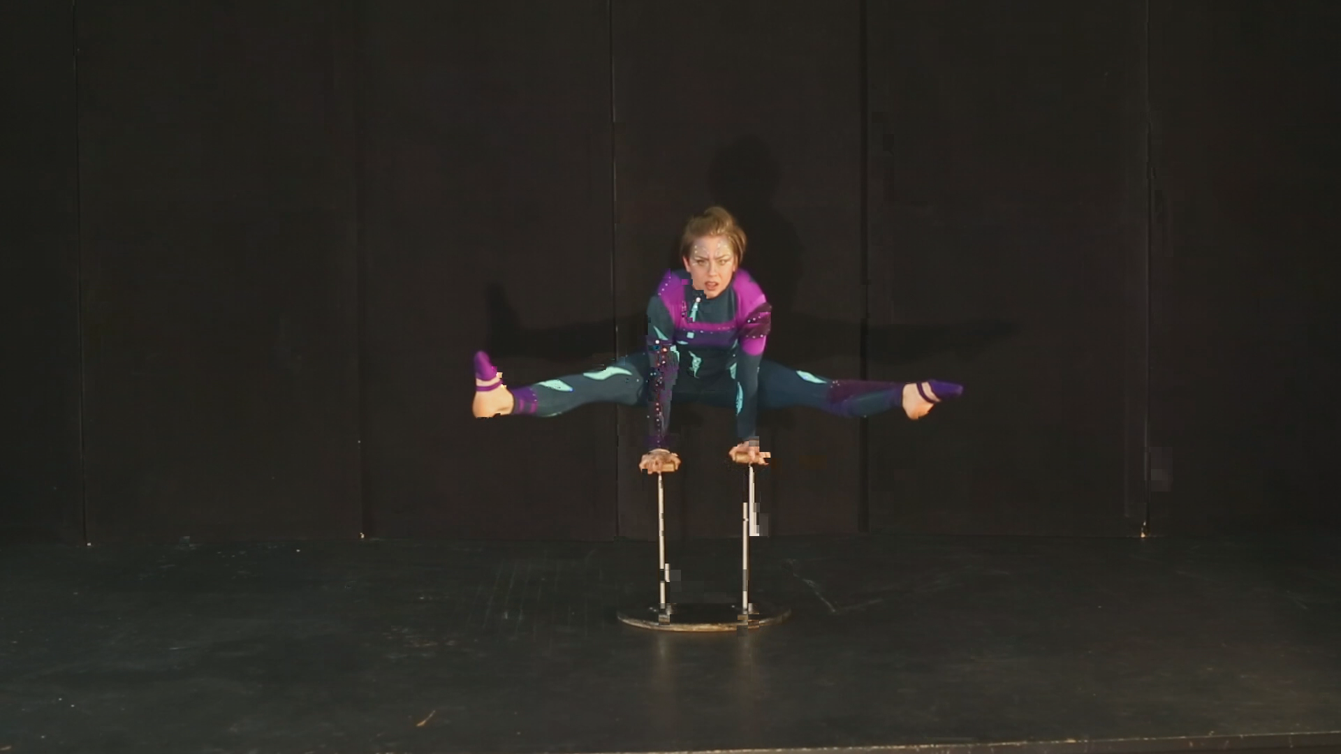

    this pic was copied to the clipboard after having made suggested changes

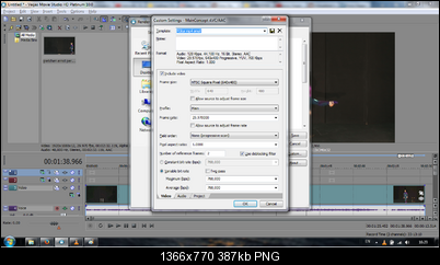

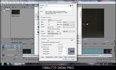

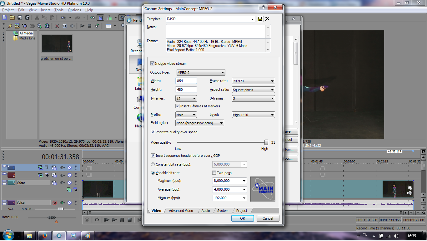

    these are 2 different render settings i tried ( i know the video size is "small" i wasn't able to render to .mp4 at 1920x1080 and it didn't allow me to do it at mpeg-2 either.)
    this snapshot was taken from a rendering. neither of the renderings worked. both gave these results
