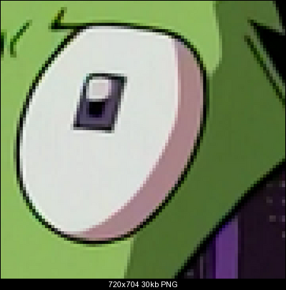

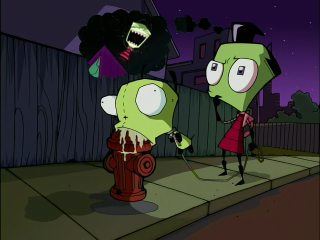

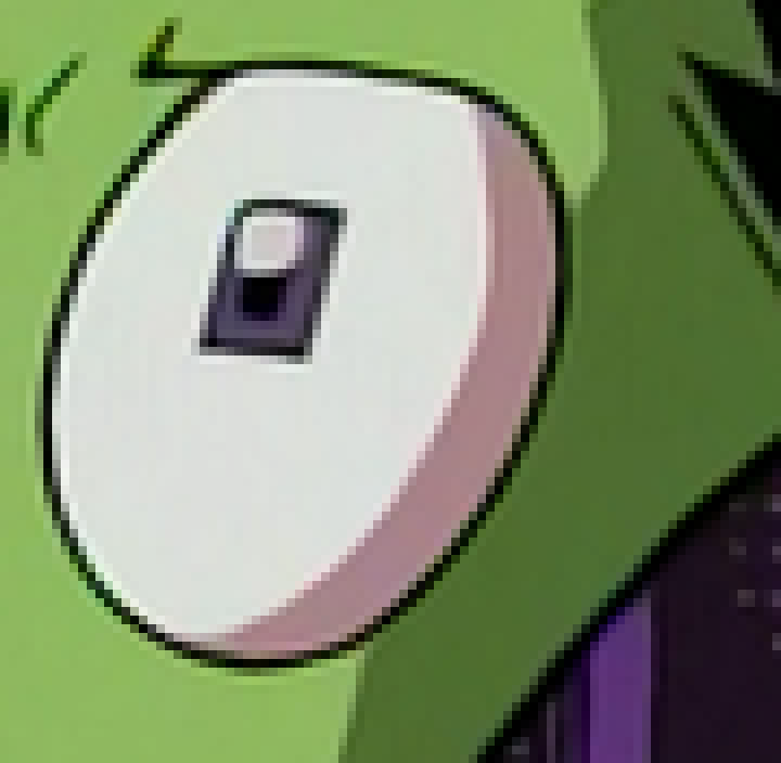

  4. Cropping away letterbox or pillarbox bars has nothing to do with whether you want to sharpen or not. (Although, if you sharpen an image with black bars you can get halos at the junction of the picture and the bars.) If you're explicitly sharpening your videos, AND using a sharpening resize filter, I suspect you're oversharpening. That can look ok when viewing a small image but it becomes annoying when watched on a big screen.
    Here's an example of oversharpening halos from a VHS deck:
    https://forum.videohelp.com/threads/361379-VCR-Hi8-capture-tests-help-evaluate?p=229264...=1#post2292646
    A small, slightly oversharpened image:
    A small section of that imaged enlarged 8x with a point resize so you can see each pixel (each 8x8 block is one pixel in the original image):
    Notice how there's a bright band around all the dark lines. And how there's a bright band and a dark band at the shaded edge in the eye. A TV wouldn't use a point resize, of course. But it would probably use a bicubic or sharper filter. That would further exacerbate the halos.
