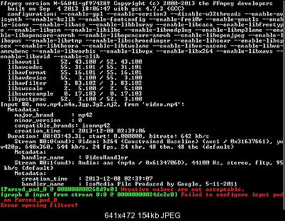

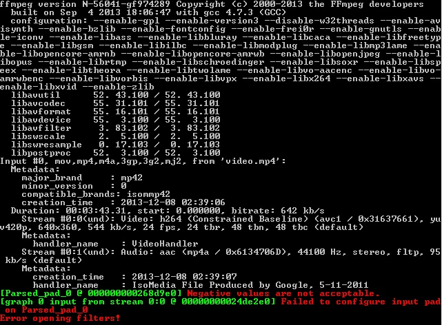

I seem to still be having an issue with this...
To be honest, I'm getting a bit lost in your parameters.. so I tried to amend the sectionto my command line as follows:Code:pad=320:240:(ow-iw)/2:(oh-ih)/2
..but it returns the following error:Code:set ffmpeg="C:\Program Files\ffmpeg\bin\ffmpeg.exe" for %%f in (*.mp4) do %ffmpeg% -i "%%f" -vf "pad=320:240:(ow-iw)/2:(oh-ih)/2" -crf:v 20 -acodec copy -vcodec libx264 -threads 0 -f mp4 -y ".\RESIZED\%%f_resized.mp4"

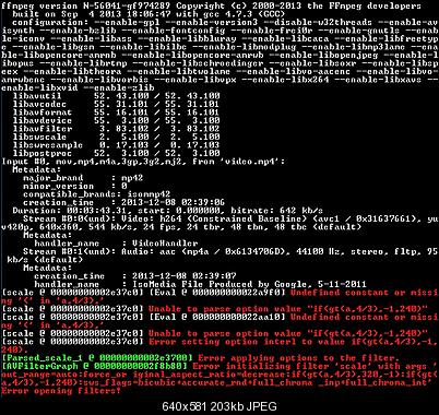

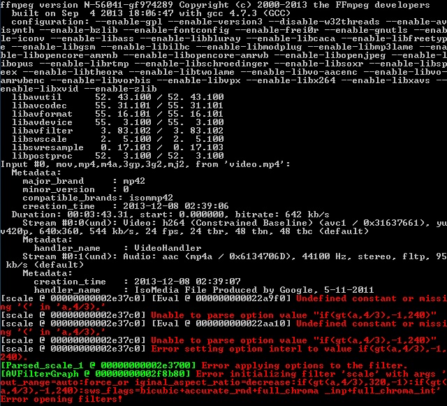

I'm getting closer.. but still no cigar..
I ran the script as follows:
..and it returned the following error:Code:set ffmpeg="C:\Program Files\ffmpeg\bin\ffmpeg.exe" for %%f in (*.mp4) do %ffmpeg% -i "%%f" -vf "unsharp=3:3:2:3:3:2,scale=out_range=auto:force_or iginal_aspect_ratio=decrease:'if(gt(a,4/3),320,-1)':'if(gt(a,4/3),-1,240)':sws_flags=bicubic+accurate_rnd+full_chroma _inp+full_chroma_int,pad=320:240:(ow-iw)/2:(oh-ih)/2,setsar=sar=1/1" -crf:v 20 -acodec copy -vcodec libx264 -threads 0 -f mp4 -y ".\RESIZED\%%f_resized.mp4"
Is there anything wrong with my parimeters? I know ffmpeg run in a batch script in win7 can get picky about things like quotation marks, etc..
Any ideas on what I'm doing wrong? -
