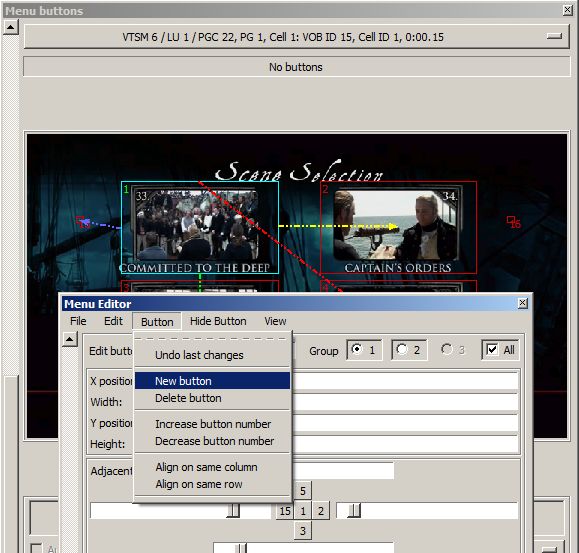

    Before I spend anymore time on it...
    Choosing a menu and selecting the 'New button' option in the Menu Editor results in the calc. error sound being issued.
    Can a new button be created in an existing menu or does the background have to be edited and a new subpic created (meaning that all the existing buttons have to be redefined in the editor).

    Both are correct but for the first you'll have no idea if the user is on the new button or not ... the sub picture helps.
    As for the error it could be indicating your trying to create a new button which is partially overlaying one ... this you can not do.
    The error is generated as soon as I opt for a new button - it precedes the selection of the location.
  4. A button can partially or even totally overlap another one, but of course, it's not necessarily a good idea. Anyway, PgcEdit doesn't check if it's the case.
    A possible cause of the error is that the maximum number of buttons is already reached. The maximum number of buttons for a 4:3 menu is 36, and 18 or 12 for a 16:9 menu. Usually, it's 18 buttons for 16:9, unless the two possible display modes (letterbox AND pan & scan) are ticked in Domain Streams Attributes. In that case, the maximum is 12.) It's because the grand total of buttons allowed is 36, but there is a different "group" of buttons for each display mode. In 4:3, there is only a single display mode, but in 16:9, there must be 2 or 3 display modes (wide plus pan&scan and/or letterbox). Therefore, the maximum number of buttons in 16:9 is 36/2 or 36/3.
    Sorry, PgcEdit should issue a meaningful error message in that case instead of simply the bell sound. [EDIT: Fixed in my code. The next version will issue an error message.]

    Originally Posted by r0lZ View Post
    Usually, it's 18 buttons for 16:9]
    That was the case here;I was adding number 19.
    I tried on another menu and the new button was created OK.
    Thank you for clearing that up for me.
