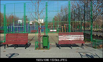

    In case someone still want to know how SD9 is behaving, I'll post the results of my testing.
    Image quality - way worse than my old CMOS Canon HF11.See attachments - sample clips shot at the same time with both of them, raw video, 1920x1080p@25fps, shutter speed 1/500, 17MBps VBR.SD9 has all the edges pixelated, even if there's no motion and in direct sunlight.It looks like either is an upscaled image or it has compression artifacts.
    Example with screwed edges (JPEG quality 100)
    Even at shutter 1/500 I've got motion blur, so next time I'll go for 1/1000 or higher.
    In terms of road footage/phantom ride the best quality I've got by shooting interlaced and deinterlacing with QTGMC.QTGMC's filters cleaned the pixelated aspect of the edges and retained some detail.When shooting 25p every second frame had motion blur.In the de-interlaced footage I had less motion blur (maybe QTGMC's doing, too).
