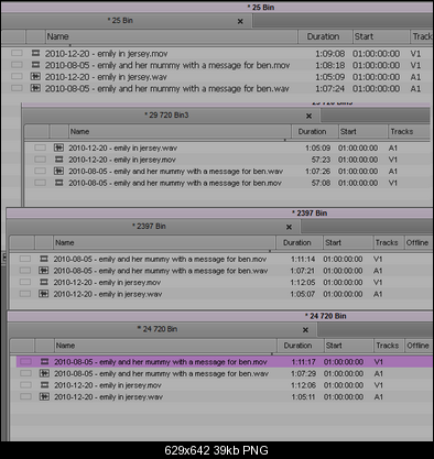

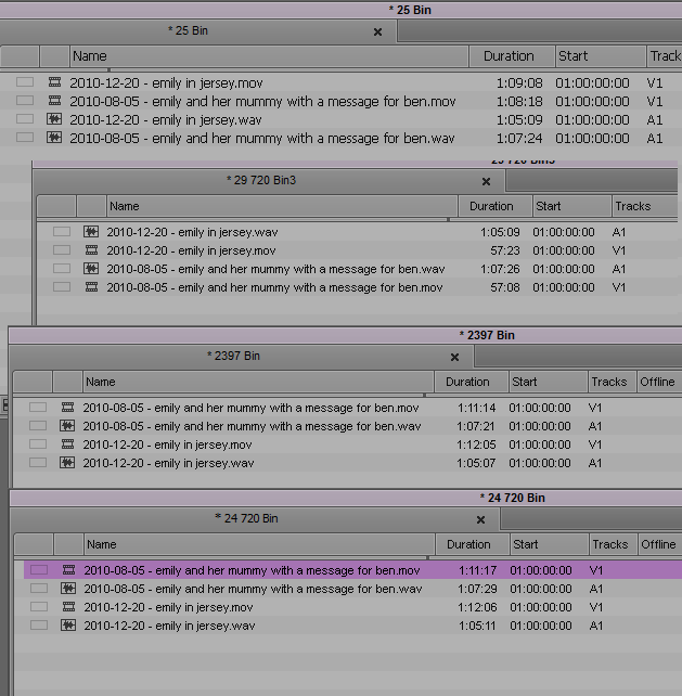

  20. Demuxing the file and playing in MPC-HC reveals that all frames are unique. The duplicates appear to be happening on playback.
    Importing the demuxed video and audio into Avid (IgnoreQTRate True) reveals that NONE of the standard frame rates are correct (match audio duration.)
    Here is a file exported from Premiere Pro (don't have elements) at 720x480 29.97p square pixels, no frame rate adjustments, no color adjustments:
