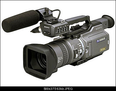

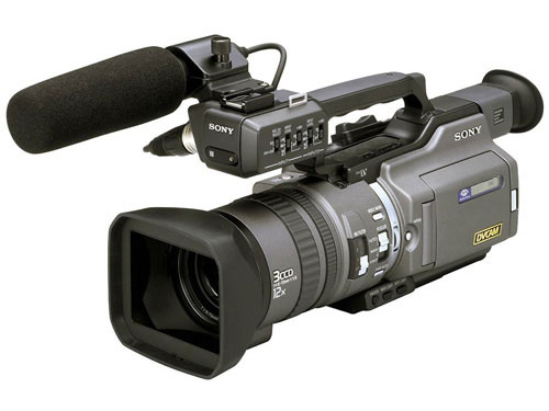

    I've recently purchased a used Sony DSR-PD170 DVCAM. I believe the camera to be in good condition. However, I'm noticing contradictions with brands of tape that I use. Initially, I had been using Panasonic MiniDV tapes with success. However, the camera doesn't record to Sony's MiniDV tapes at all. The results are just blank! As you can imagine, I was freaked-out when I saw nothing on a pro-bono job I did. Is there a camera mode that I'm not aware of? I'm new to videography and would like some direction about the type of tape brands I should steer away from. I'm taken a-back with this issue because I'm using a Sony camera and experiencing problems with a Sony tape product. Or, maybe I simply need to be educated more about how to use my camera. Some direction is greatly appreciated!

  2. Member zoobie's Avatar
    Feb 2005
    Florida
    Different brands use different methods of lubrication. However, I think you better have your used cam checked out. It may simply have a loose connection.
  3. Look for a DVCam/DV switch. It's a shame to use such cheap-ass tapes on such a classic old camera though. You'll get reduced PQ due to flaking and reduced head life due to inferior lubricants.
  4. Lubricants? Lubricants used in the tape? Pardon my ignorance but are you saying both these tape brands are inferior? What tapes do you recommend I purchase for use in this camera?
    And yes, I will have my camera looked at by a repair shop in NYC.
  5. Get Sony DVCam professional tapes (Sony Professional HDV tapes are the same thing.). They are more expensive and more rugged and designed for reliability.
