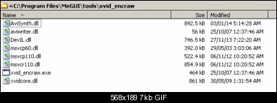

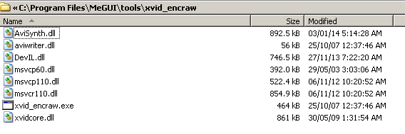

    By the looks of it MegUI has been using the same Xvid version for quite a while, but after updating, it might pay to check the tools/xvid_encraw folder to make sure all the required files are there. I don't really know much about xvid_encraw, but my folder looks like this:
