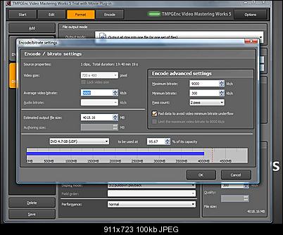

    I just installed the TVMW5 trial myself. It is possible to specifiy the average
    bitrate exactly. I'll try an encode and see what I get.

    The bitrate achieved from my test encode was 5192 kbps, approx. 92.5 % of the requested bitrate (5600 kbps),
    even after setting it up as an mpeg output. It's using the standard mpeg (modified) matrix that many of these products use,
    should be OK at this average bitrate. I'll have another look at it.
