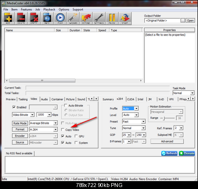

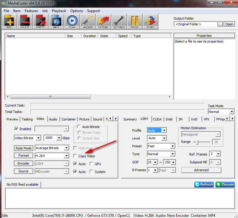

    did you try mediacoder? it has a "copy video" option that passes it through.
  10. I too would use MediaCoder. I would choose to disable the video alltogther which gives you an AC3 (stereo) audio file as output (untick Enabled on the Video Tab) and then mux that with your source. (Use Stereo on the Sound Tab)
    However, if you find it an "userfriendly GUI" is up to you to decide.
