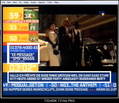

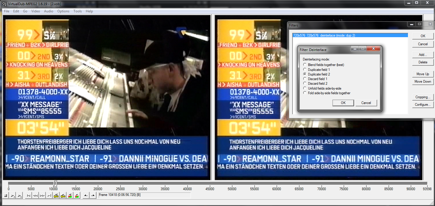

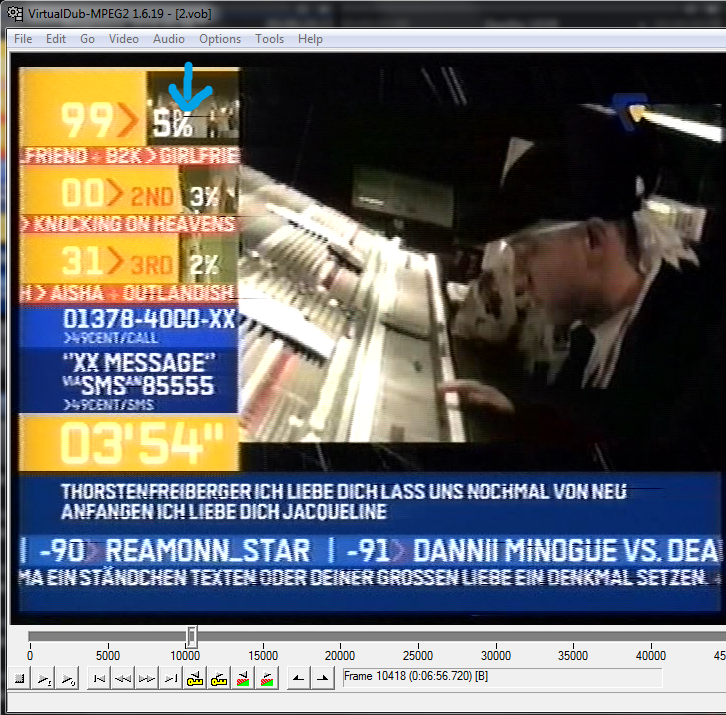

  1. I have an old tape from an old recorder which didn't exist anymore.
    In one field i have black streaks.
    I can duplicate the "working field" with VirtualDub but it looks very angled and I don't want to deinterlace it actually.
    Is there an other method to fix that?
Name:	black streaks.png
  2. Black "comets" like that can be removed with three caps and a median filter if they appear in different places each time you capture. Also, since the appear in only one field, a head cleaning might help. But I guess you no longer have the tape.
    A filter like RemoveSpots or RemoveSpotsMC in AviSynth can sometimes get rid of them. Can you upload a short sample?

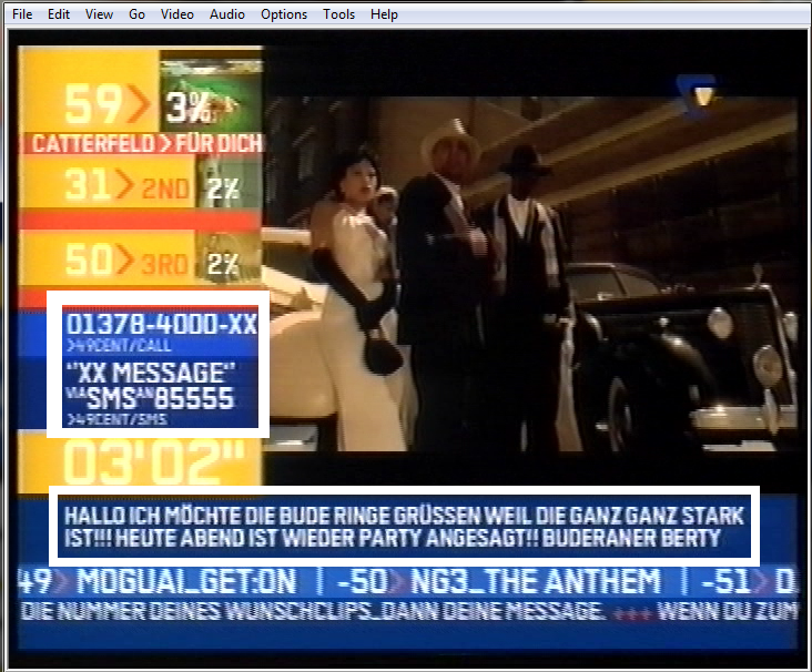

  6. Is you whole video like the sample? With the small live picture in the top right and text overlays at the left and bottom? I only saw comets in the text (except for a few times where the tail of the comet reached into live picture).
    A sequence like this helps with the text overlays:
    SeparateFields()
    PointResize(width, height*2)
    odd=SelectOdd()
    evn=SelectOdd().DoubleFPS2().SelectOdd().Loop(2,0,0)
    Interleave(evn,odd)
    PointResize(width, height/2)
    Weave()
    That works by substituting the even field with a motion interpolated version of the odd field. It does leave a few artifacts from the motion interpolation. I'd use Overlay() to keep the original live video part of the frame intact.

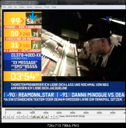

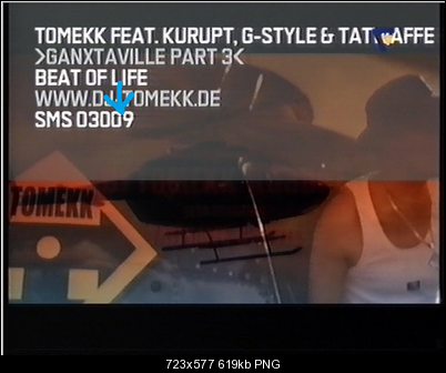

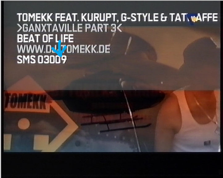

  7. Sometimes there are comets here (arrows), but 90% of the recordings are like the sample.
Name:	black streaks2.png
ID:	22633 Click image for larger version
Name:	black streaks3.png
    Trying your script get an error that he don't know the function named DoubleFPS2 and I can't find the script/plugin for that.

  9. OK, but don't know whyI can't find this post with google...

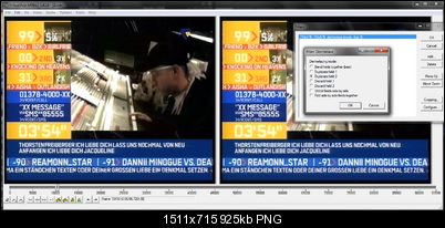

    Now it worked. The "still standing" texts are angled as I use the dublicate Filed in VirtualDub.
    But I think it doesn't go better.
    Is there no opportunity to remove the comets with only 2 clips instead of 3 clips?
    I know, that 50% of the comets are in both clips but I want to try it and decide, which method I'll choose.

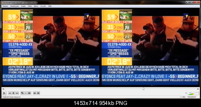

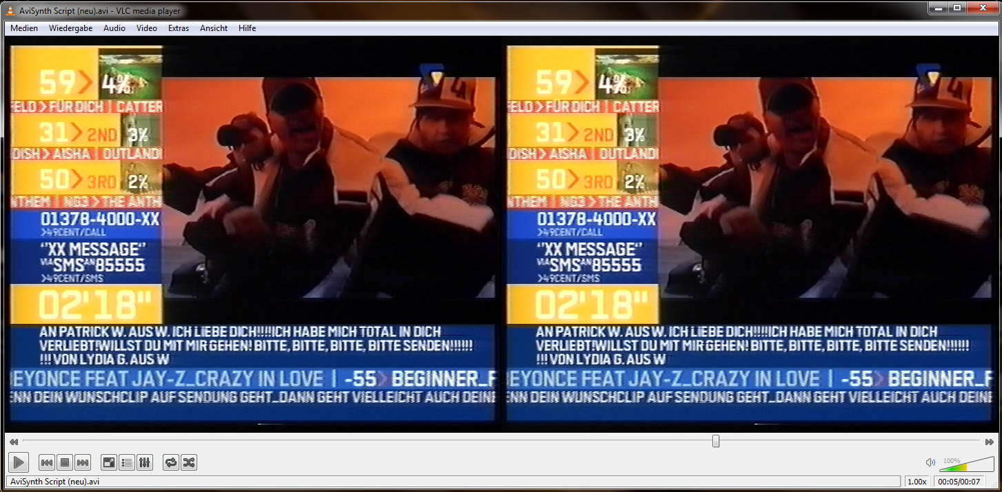

  14. This is strange. Load your script but the comets are there anyway.
    Theres no defference between the original.

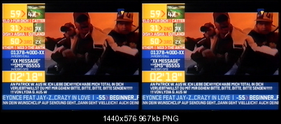

  15. The last line of the script displays the original video on the left, the cleaned video on the right. Make sure you've viewing the entire frame (1440x576).
  16. Yes, I rendered the few seconds of the video and I get a "side by side" video. But so different between left and right picture.
Name:	no effect.png

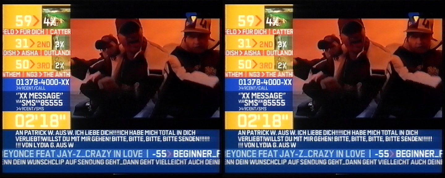

  17. Here's the same frame on my computer:
  18. Looks good!
    But don't know, why it's not working on my computer.
    Does it work with (interlaced) avi too?

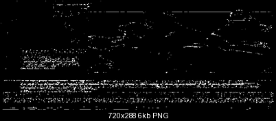

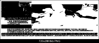

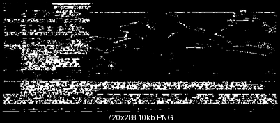

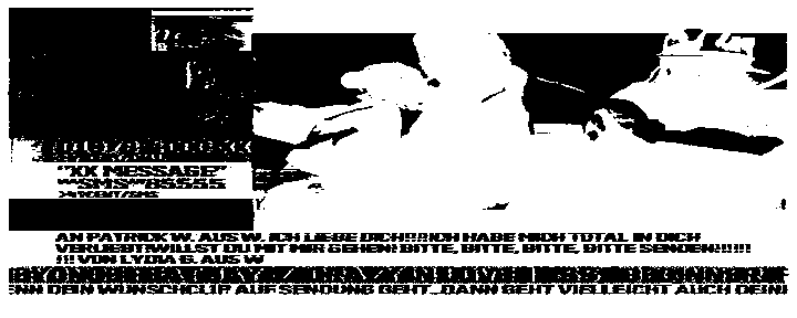

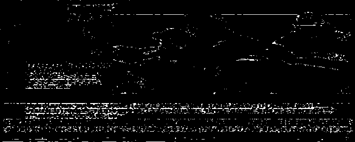

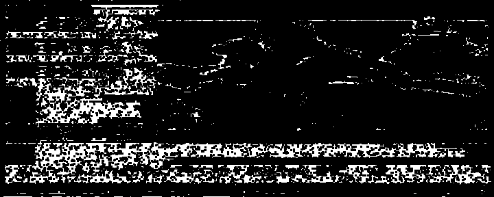

  19. Maybe you have different version of mt_masktools? Look at edges, dark, and mask. From frame 127:
    edges:
    dark:
    mask:

  20. I see no mask. It's strange.
    Can you put your mt_masktools plugin in a zip and upload it? So then we can see if it's the plugin problem.
  21. So mask was all black? What about edges and dark? Here's the version of mt_masktools.dll I'm using.
  22. OK, but don't work again.
    The mask don't work on each frame. It's black and in some frames I see a mask. Very confusing.
    Here the return(mask) video. (Take Xvid for smaller videofile)
  23. Look at edges and dark. Do they look like the images I posted?
