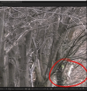

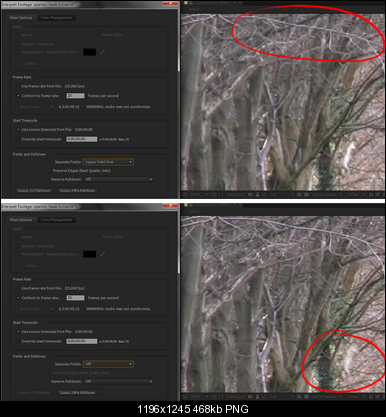

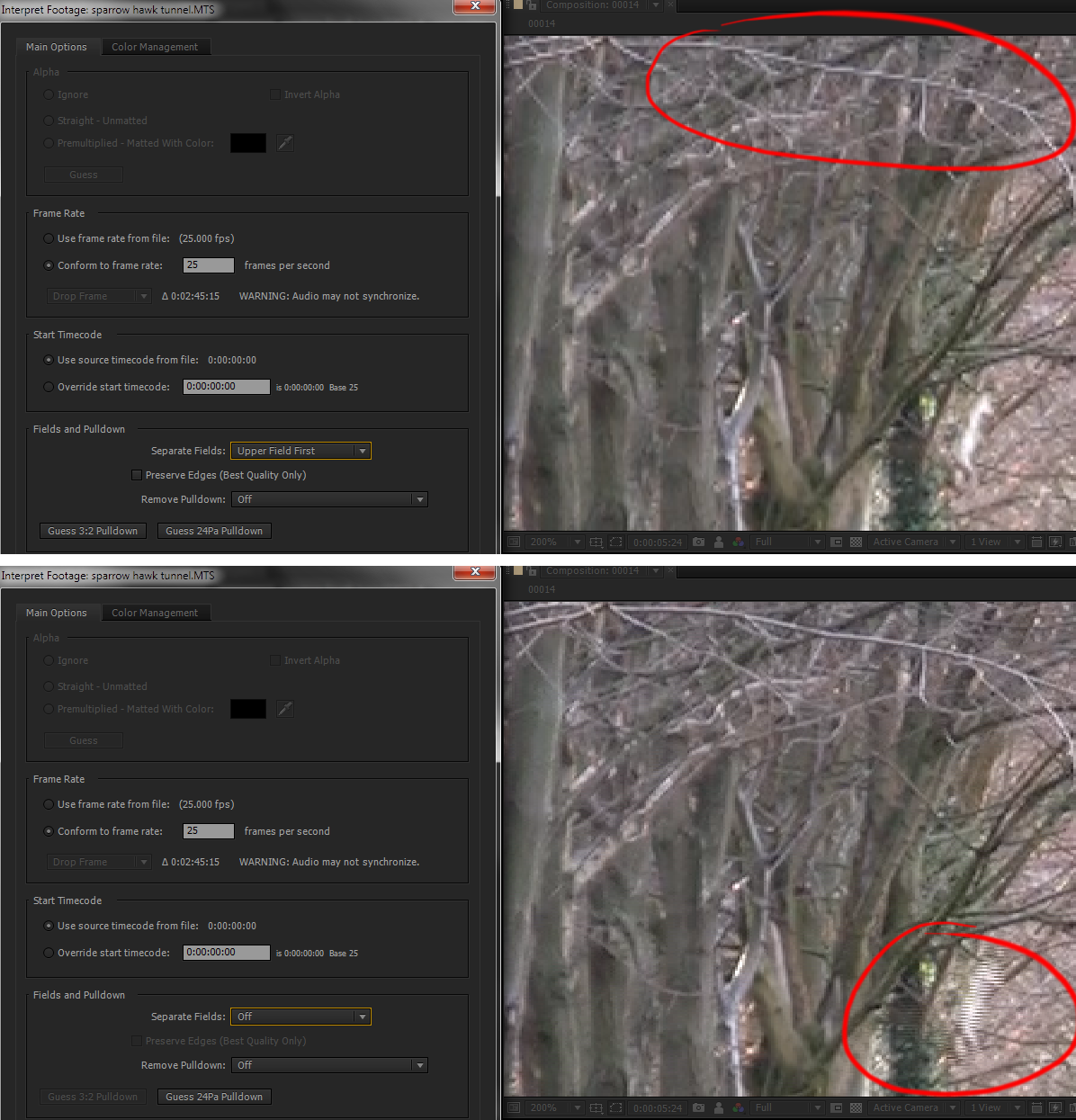

    I hope you can see the image at large size to understand my issue. Basically, I have a large collection of *.MTS footage from a Canon HG10 that I want to use for a high quality edit in Adobe After Effects CS5.5. I have been aware of the difficulties with AVCHD footage, and have never been able to find a perfect way to play them back. VLC gives me some combing, but AE seemed to read the files fine, and I can render reasonably quickly with my machine.
    However, on closer inspection I noticed that line detail seemed to gain an aliasing effect on import (see jaggies on branch in the top image). This is not present on the original MTS clip played with the camera or through VLC media player. It is present within After Effect's preview window, a lossless AVI render from AE, and through Windows Media Player.
    I noticed that by default AE interprets the footage as Interlaced, upper field first. I thought this was the key to my issue, as it might be that some software (AE and WMP) misinterprets how the clip is wrapped (..I don't have much technical knowledge, I've just read around a bit). Anyway, I change the clip settings in AE to force progressive (by turning off separate fields). The jaggies vanish and clean up my image quality.. BUT, I am now faced with interlacing flicker and combing on any moving parts (see bottom image).
Name:	Upper v P.png
    I have tried every combination on those dropdown menus / check boxes, but I either get jaggies or combing. I also tried a tool that rewraps the file as a MOV and an MP4, but both have the same problem. I also tried a tool that transcodes the file to AVI. This also resulted in the same problem and an unmanageble file size for the whole project. It seems like the only way I can see the clips without any decoding errors is through the camera. I have searched the net endlessly and know there is a lot of stuff on this..but I'm really stuck here! Please tell me there is a way to fix this!
    PS the project will involve 250 clips at around 50GB. Quality is important and eventual use will be an HD upload to Vimeo.

    Hi Jagabo, do you mean the branch with jaggies (upper field first) or the combing (forced progressive)? I'm not sure which artefact shows a bob/discard field?
    So, if I've got this straight - the footage was probably shot as 50i, and most software struggles to deinterlace it accurately. I need to use a tool such as 'QTGMC' to transcode to an intermediate lossless format before editing. ?
    Are there any recommendations for my method?
    Another question would be - for shots where there is little movement, can I continue using the MTS footage in forced progressive alongside my converted files in 25p?
  5. Originally Posted by jonfopp View Post
    Your deinterlaced shots show an obvious "discard field" or "bob" deinterlace. You'll need a better deinterlacer to get rid of those artifacts. You may find Yadif adequate. QTGMC is usually the best.
    I meant the jagged branch in the top image. It's jagged because every other scan line was discarded.
    Your lower image image is showing both fields so you see comb artifacts where things are moving. Interlaced video is intended to be viewed one field at a time. So 25 interlaced frames per second should be viewed as 50 fields per second.
