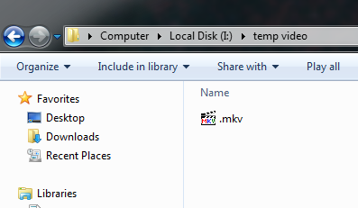

    it's where you saved it and is named .mkv i made one and it's there.

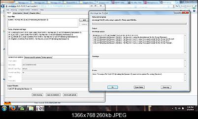

    Well your response gave me the idea to do some tests, and I've concluded that there must be a bug with a queue system for mkvmerge. That or I am using the program incorrectly, which is more than likely.
    I re-created my original scenario, where I point mkvmerge to output a file that isn't named, only its location is named. When I try to mux the video using the GUI of mkvmerge (not the queue), I instantly get an error code, as I should.

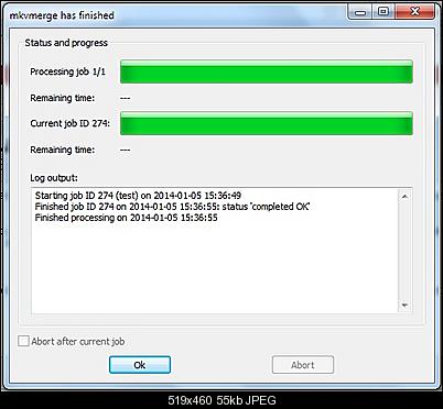

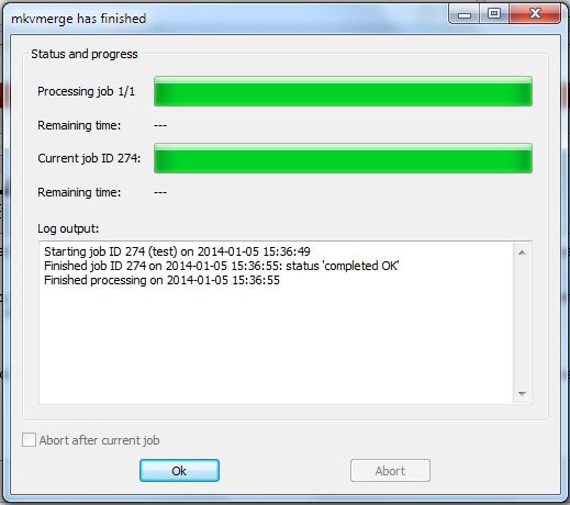

    However, when I add that job to the queue, and then run the queue, the end user would think the file is processed normally, even after looking at the log.
Name:	successful queue.jpg
    --- BEGIN job 274 (test, added on 2014-01-05 15:36:42), started on 2014-01-05 15:36:49
    mkvmerge v5.2.0 ('I can't explain') built on Dec 18 2011 18:12:03
    'I:\AC3\TV\Breaking Bad\Season 3\S03E01 - No Mas.mkv': Using the demultiplexer for the format 'Matroska'.
    'I:\AC3\TV\Breaking Bad\Season 3\S03E01 - No Mas.mkv' track 0: Using the output module for the format 'AVC/h.264'.
    'I:\AC3\TV\Breaking Bad\Season 3\S03E01 - No Mas.mkv' track 1: Using the output module for the format 'AC3'.
    'I:\AC3\TV\Breaking Bad\Season 3\S03E01 - No Mas.mkv' track 2: Using the output module for the format 'VobSub'.
    The file '.mkv' has been opened for writing.
    The cue entries (the index) are being written...
    Muxing took 5 seconds.
    --- END job 274, finished on 2014-01-05 15:36:55

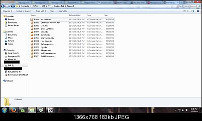

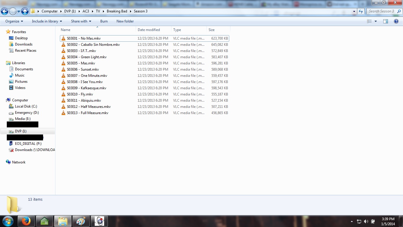

    Yet the file does not exist in the intended output location:
