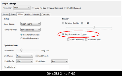

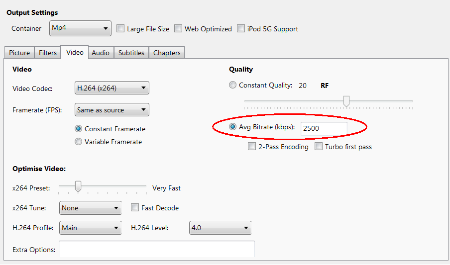

  5. For duration 04:43 to not over 100mb
    Set Normal preset
    Set Avg Bitrate to 2500:

    "Set Normal preset
    Set Avg Bitrate to 2500"
    All done, and no change.

    Did you use "constant frame rate" as shown in the screen shot ? "variable frame rate" might cause some issues with some decoders if it's a re-encoding site

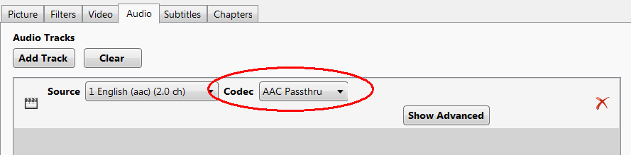

    Try the audio passthru option in handbrake instead (it will copy the audio, instead of re-encoding it)
    Jan 2014
    England
    Would you use AAC Passthru or Auto Passthru

    Just saw image of passthru, thanks.

    Hi guys, looks like the Audio PassThru worked!! Vid works fine now. Thanks to all you guys that helped out!! Legends!
