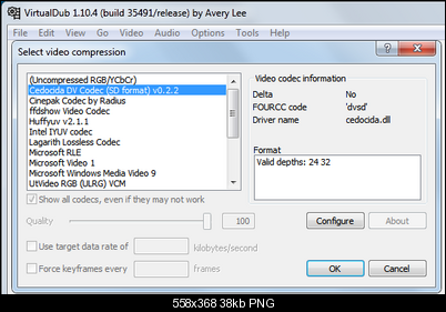

  2. 32 bit programs require 32 bit codecs. 64 bit programs require 64 bit codecs. The two systems cannot see each other. Cedocida.dll in SysWow64 it's the 32 bit version. Cedocida.dll in System32 is the 64 bit version.
    To check, start 32 bit VirtualDub and select Video -> Compression... and verify Cedocida is in the list of codecs. Do the same with 64 bit VirtualDub.

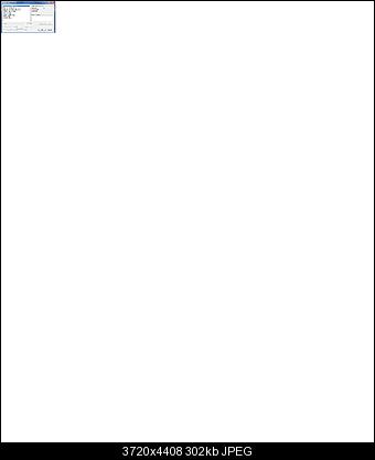

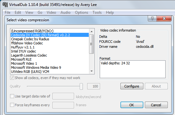

    Well shows I get confused, I assumed that SysWow64 was for 64bit and System32 for 32bit ........ and it's the other way round ?
    Anyway I looked in VD 32bit and it shows 3 variants, so must be installed.
