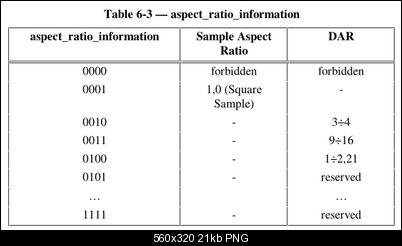

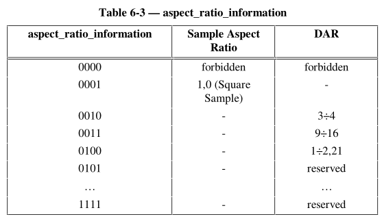

  20. The aspect ratio flag in an MPEG 2 video is a 4 bit integer. Of the 16 possible values, only 4 have been defined. From the MPEG 2 spec:
    So the only way to get a 2.39:1 DAR image is to use 2.39:1 frame dimensions and square pixel encoding, or to use one of the other DAR flags (2.21:1, 16:9 or 4:3) and add a sequence display extension to indirectly specify the DAR of the full frame.
    For example, using a 720x480 frame and 16:9 DAR flag, you can set the sequence display extension to 540 (x480). That will give full 720 pixel wide frame a DAR of ~2.37:1.
    Or set the sequence display extension to 536 to get a DAR of ~2.39:1. But I don't know if 536 (neither mod 8 nor mod 16) is legal.
    And again, many players ignore the sequence display extension. So this is not a reliable method.
