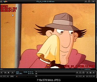

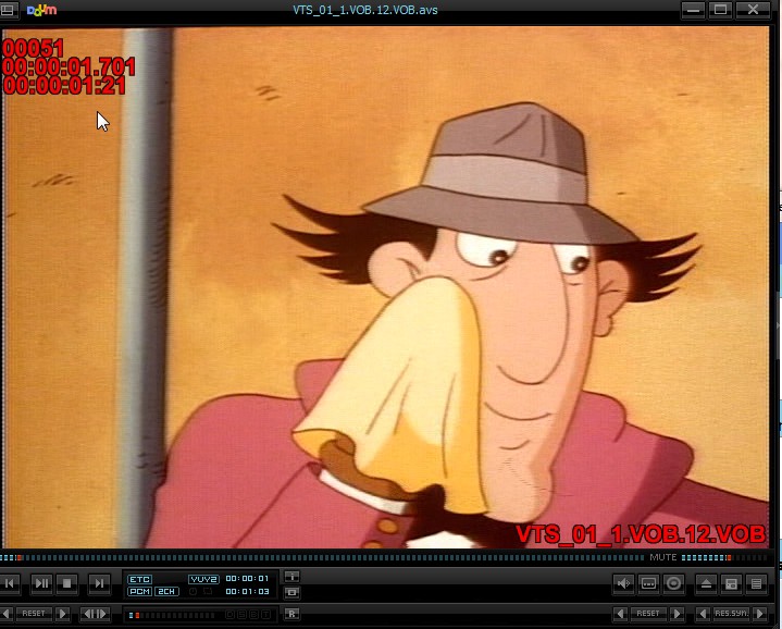

    If you are talking time codes like for each frame (00:00:00.000), you can use Avisynth and a player such as Potplayer that has seek and frame by frame advance.
Name:	ScreenHunter_49 Jan. 04 00.11.jpg
    I wrote a little GUI to do this for just that reason but the script is rather simple:
    LoadPlugin("C:\Program Files (x86)\AviSynth 2.5\plugins\ffms2.dll")
    A = FFAudioSource("C:\Users\Bud\Desktop\VTS_01_1.VOB.1 2.VOB")
    V = FFVideoSource("C:\Users\Bud\Desktop\VTS_01_1.VOB.1 2.VOB")
    AudioDub(V, A)
    Normalize()
    Subtitle("VTS_01_1.VOB.12.VOB", font="Arial", size=24, text_color=$ff0000, align=3)
    ShowFrameNumber(scroll=true, x=10, y=27, font="Arial", size=24, text_color=$ff0000)
    ShowTime(x=72, y=44, font="Arial", size=24, text_color=$ff0000)
    ShowSMPTE(fps=29.97, x=68, y=61, font="Arial", size=24, text_color=$ff0000)

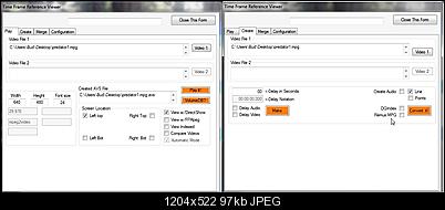

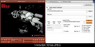

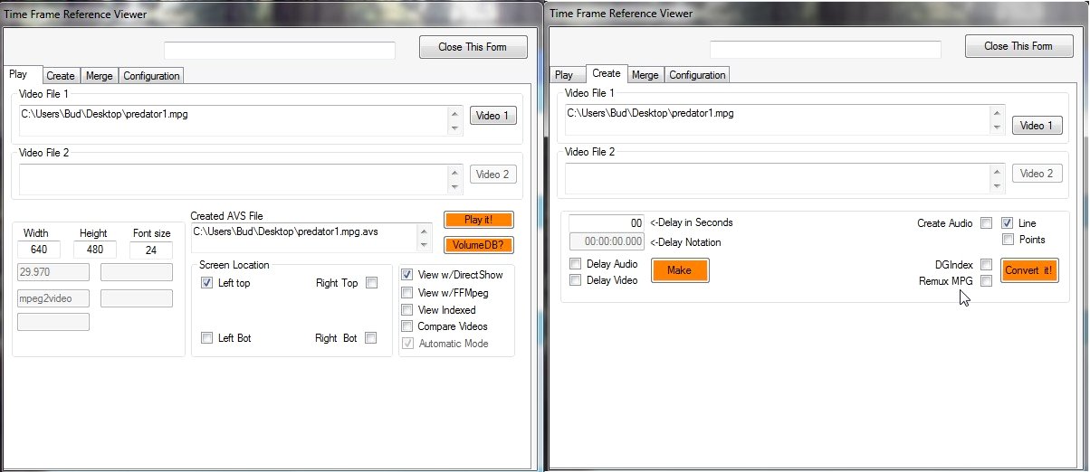

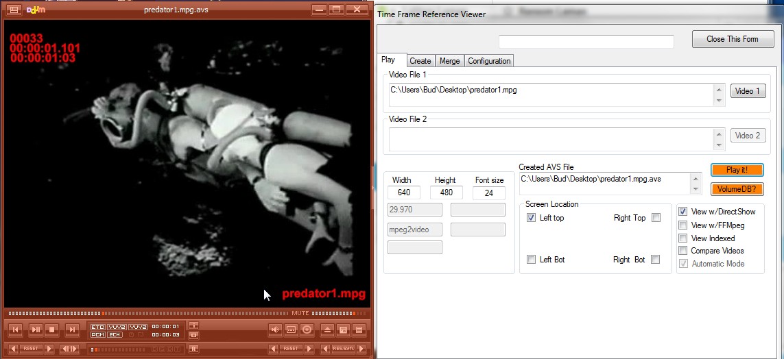

    Although I do not have a 4GB file either, The method I use, actually my GUI, creates the Avisynth script and laumches it in Potplayer which will seek and frame by frame ('F' = forward 'D' = Backward). I will have to experiment now that you mention the time but it does create the ffmsindex file so it should not take too long. The Gui just keeps me from having to create the AVS file for each video I drag and drop.
Name:	ScreenHunter_49 Jan. 04 15.46.jpg
    Right now the above is an all encompassing program that also allows entering and executing Command lines (ffmpeg use).
    It does not install but uses FFMpeg as well as other tools all incorporated into it so the file size is larger than some simpler utilities. Right now it is for my purposes and includes: DGDecode.dll, DGIndex, ffmpeg, ffms2, FLVcheck, FLVMDI, FLVMeta, MediaInfo andTsmux. This was the reason I just gave the script for your purposes and request.
    If the time to load a 4GB file is not excessive, I'll try to offload a version with just the time code use if you can still use it or have not found another way.

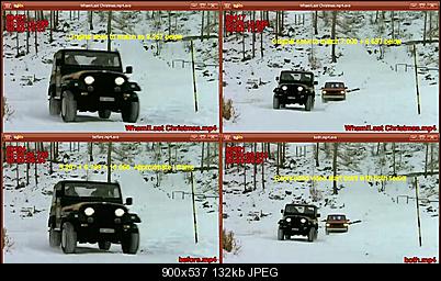

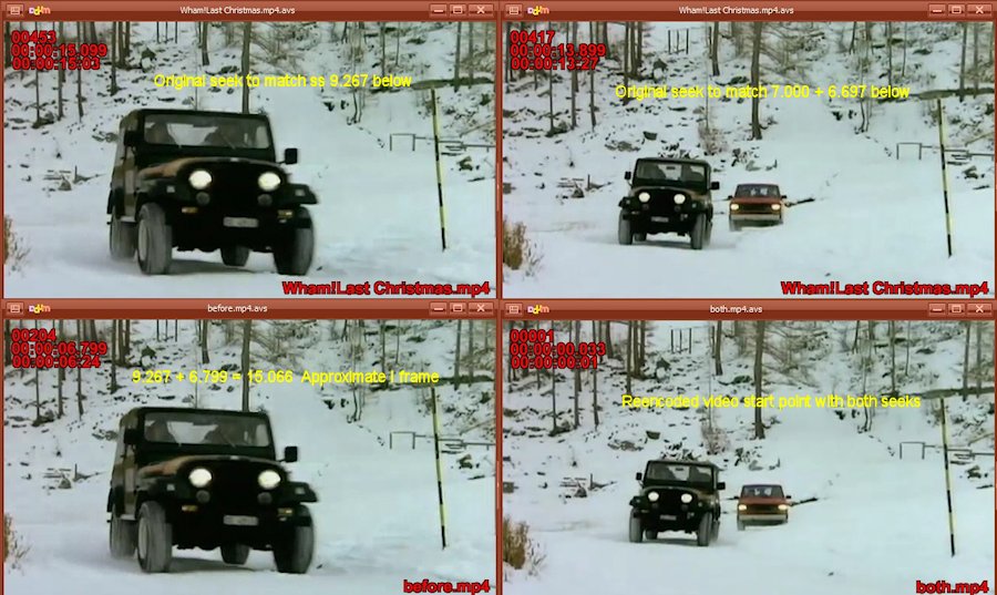

    From what I have experienced and understand, if you specify -ss xxx before the -I video (ffmpeg -ss 00:00:05:00 -I videoin videout) it searches to the I frame then if you search after the -I videoin it searches slower but to the exact frame. So if you wish to go to a certain frame specify such as:

  26. Member Budman1's Avatar
    Jul 2012
    NORTHWEST ILLINOIS, USA
    Okay here's the output I tested with. I have an MP4 with key frames at approximately 8.3696 seconds and 15.9363 with in the first 20 seconds. If I use :
    ffmpeg -ss 00:00:07.000 -i "C:\Users\Bud\Desktop\mpg test\Wham!Last Christmas.mp4" -ss 00:00:06.697 -vcodec copy -acodec copy both.mp4
    The video jumps to the 15.963 (approximately) which is the next I-frame after 6.697 + 7.000 = 13.697. Further testing showed the -ss 07.000 alone causes a cut at the first I-frame after which is the 8.396 one. So it appears that if either seek goes to the NEXT I-frame.
    HOWEVER, if I actually re-encode using :
    ffmpeg -ss 00:00:07.000 -i "C:\Users\Bud\Desktop\mpg test\Wham!Last Christmas.mp4" -ss 00:00:06.697 -vcodec libx264 -acodec copy both.mp4
    It recodes to the 13.963 position unlike when video used copy codec designation.
Name:	ScreenHunter_51 Jan. 11 01.51.jpg
  27. So it works like this:
    • -ss X -i .. -ss Y -c:v copy => seeks to first I-Frame after X+Y and starts copying from there
    • -ss X -i .. -ss Y -c:v libx264 => seeks to X+Y and starts encoding from there. (!important!: this will only work if there's a gop boundary between X and X+Y)
    right?
    ("It recodes to the 13.963 position" confused me)
    What happens if you use:
    • -ss X -i .. -c:v copy
    • -ss X -i .. -c:v libx264
    • -i .. -ss X -c:v copy
    • -i .. -ss X -c:v libx264
    (does it change depending if X is right before or after a key frame?)

    This is only an assumption on my part because I do not know the ffmpeg source code but it makes sense that if you COPY and do not reencode then ffmpeg must cut at its nearest I - frame which has always been the NEXT one after the -ss xxx. This has always been my experience while experimenting.
    It also makes sense that if I used a codec, libx264 for example, ffmpeg will reencode at the point of the second -ss (I... -ss xxx) turning that frame into an I frame? I must admit this is beyond my knowledge at the moment but that is what occurs when I analyze the different conversion of an MP4 in your examples.
    UPDATE: Looks like the latest FFMpeg has fixed it so the -ss xxx preceding the -I is now frame accurate as well.
    when transcoding with ffmpeg (i.e. not streamcopying), -ss is now accurate
    even when used as an input option. Previous behavior can be restored with
    the -noaccurate_seek option.
    I tried with an arbitrary 13 seconds seek with the new ffmpeg (ffmpeg-20140110-git-d9481dc-win32-static) and copy actually worked EXCEPT the resulting 29.97 FPS video had 10 duplicate images at the beginning, all from the 13 second point in the original video. With further analysis, it looks like it copied the audio from near the 13 second mark but had to duplicate frames in the video to achieve sync.??? It appears, in order to achieve that exact seeking in the preceding type -ss xxx, ffmpeg now does some manipulation (duplicate frames) to achieve what I asked, copying the audio from the 13 second mark.
    Think I'll stay with the old dual -ss xxx method unless I want 3/10 of a second frozen image set to music.

  30. Member Budman1's Avatar
    Jul 2012
    I call mine which launches whatever player you wish):
Name:	ScreenHunter_51 Jan. 13 22.27.jpg
