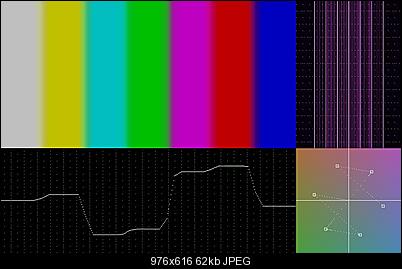

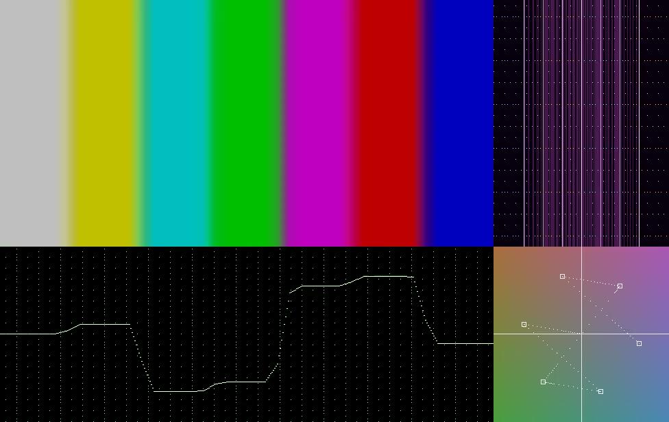

    I don't find the UV vectorscope to be very useful unless you have SMPTE color bars to calibrate to:
    That's a VideoScope() UV graph in the lower right corner. The crosshairs and small white boxes over the UV graph are an overlay indicating the standard SMPTE colorbar locations. At the top right is the U waveform graph, the bottom left the V waveform graph. The color bars are blurred so you can see dotted lines between the points in the UV graph. If the bars were perfectly sharp you would see only a dot in each box. Hue rotation animation attached.

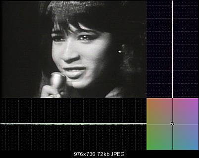

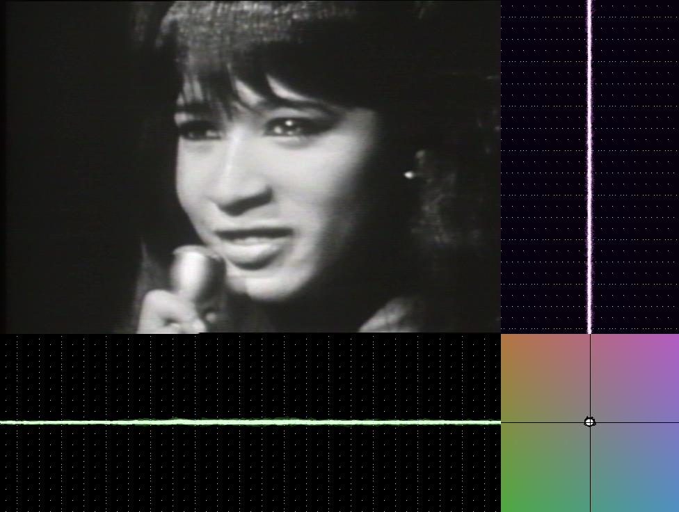

    Another place this can be useful is when checking for white balance (how pure the greys are). You can crop away parts of the frame leaving only something you know should be grey then view the UV plot to verify the picture is clustered around the center. Or you can view the U or V waveforms and verify they are at 128:
    This was a noisy analog capture of a b/w video. You can see that there's chroma noise in the signal because the U, V, waveforms aren't perfect thin lines, and rather than a single dot at the center of the UV plot there's a fuzzy ball.

    You can see the problem in the gray image using a pixel sampler. All areas are a bit yellow. Readings off most areas show a slight deficit of blue. Of course, it also depends on how the jpg image was made.
  10. Originally Posted by sanlyn View Post
    Yes, you can also see that the spot in the UV graph is slightly off center.

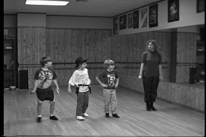

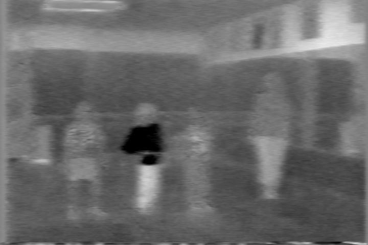

    The attached image is an "after" version of interlaced frame 62 from c hi8 TapPractice trv480 -tbc-dnr, composite 550 vdub B109-C148-Sh0 clip2.avi . A few things were fixed with a collection of light-duty tricks: reducing aliasing and edge noise, oversaturation, ringing, halos, edge ghosts, oversharpen effects, and most (but by no means all) chroma shift, bleeding, and edge ghosts.....not to mention a pesky case of dot crawl, which looked more obvious in the DV versions. One thing about tape: it will always look like tape. It won't look like DVD. But it can look a lot better than "just tape".
    [Attachment 23669 - Click to enlarge]

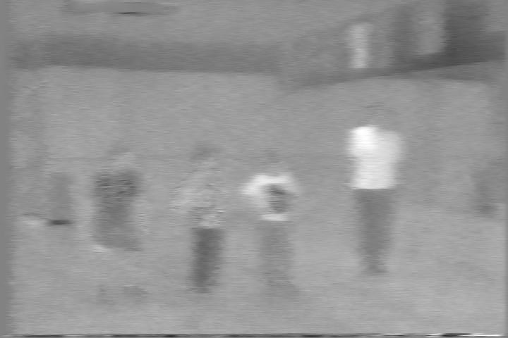

    Then suffice it to say the chroma resolution is far lower than the luma resolution on the horizontal axis:

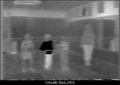

    Y:

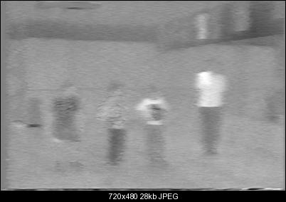

    U bicubic scaled to the same dimensions as the Y channel, contrast enhanced to increase visibility:
    V:

    The image I posted in #170 should offer some anti-bleed encouragement. Not perfect, but it sure beats the original.
