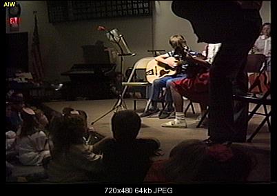

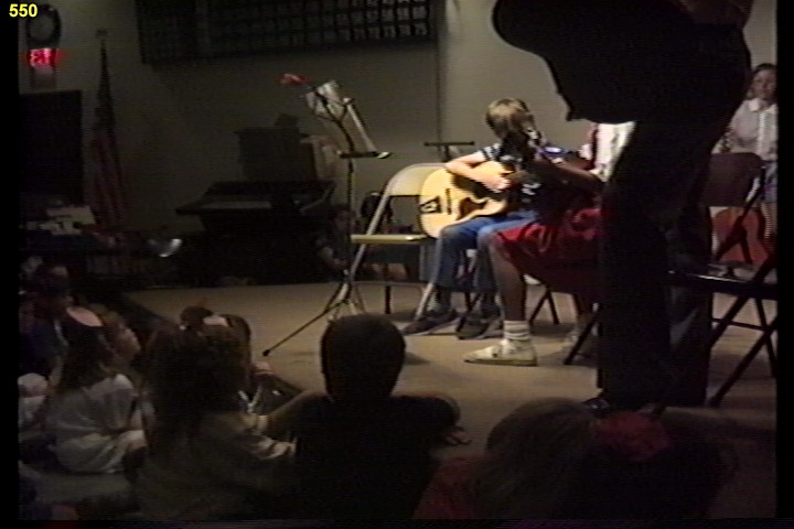

  3. I'd say the JVC deck is out of the running because of its bright crush problem.
    The 550 and AIW are a mix. It looks like both can be adjusted (via their proc amps) to get levels within reason.The AIW has color artifacts from the less than ideal comb filter (2d vs 3d) and has more over sharpening halos even though its picture is not as sharp. The 550 and AIW are a mix. Both can be adjusted to get levels within reason. I don't know exactly what the colors should be but I think the AIW has more accurate colors and to the extent they are off they can be more easily fixed.
    Here are frames from the two caps adjusted to similar levels and saturation:
    550:

    AIW:
    I guess the 550 cap is still a little more saturated than the AIW cap overall. But the guitar is significantly more saturated in the 550 cap. If you test for valid RGB colors the guitar is mostly illegal. You have to reduce the saturation quite a lot (otherwise significantly under saturated) to get it to legal RGB values.

    See very little difference between the 2 pics. Girl's white shirt seems too bright in both, but more so in AIW. Similar for the guitar, but to a lesser extent. Maybe proc amp Contrast level still too high and detail lost there? Of course, it's possible that the camera "did it" and the capture is ok, I suppose.
    I see the following controls in VDub's link to my AIW capture drivers: Brightness, Contrast, Sharpen, Hue, Saturation.
    Should I have turned off all other proc amp levels except Brightness & Contrast? Didn't think about that. The Sharpen was set to 0 for the 550, disabled for the AIW. I left the others at default.

    Yes, my point was that the two very different looking captures could both be adjusted to something like the full range of brightness and they would both look about the same -- neither is crushing brights or darks like the JVC deck was.
    The automatic gain controls on most camcoders (and other image/video devices) shoot to get ~95 percent of the image in the middle brightness range -- so small areas of darks and brights often get crushed. I could have used less gain on the brights making them less bright but there would still be little detail there. As it was, I just moved darks down to near the standard black level, and the brightest parts up to something near the standard white level. Of course, not every shot needs to use that full range. It's a bit of an artistic decision how dark/bright you want the extremes to be (and the gamma of what's in the middle).

    ColorMill(25702, 25698, 25697, 24416, 25704, 25700, 29044, 25713, 25700, 25700, 25444, 25700, 25700, 1124, 2053)
    CCD(20,1)
    #----- Re-interlace + new black borders
    AssumeTFF().SeparateFields().SelectEvery(4,0,3).Weave()
    Crop(16,0,-16,-10).AddBorders(16,4,16,6)
    #----- To YV12 for encoding.
    ConvertToYV12(interlaced=true)
    return last
    # ------------------- Contrastmask function used above -------------------
    function ContrastMask(clip v, float "gblur", float "enhance")
    enhance = default (enhance, 10.0)
    gblur = default (gblur, 20.0)
    enhance = (enhance>=0.0 && enhance<=10.0) ? float(enhance*0.1) : 1.0
    v2=v.Tweak(sat=0)
    v2=v2.invert()
    v2=v2.gaussianblur(50.0,50.0+gblur)
    photoshop_overlay=mt_lutxy(v,v2,"x 127.5 > y 255 x - 127.5 / * x 255 x - - + y x 127.5 / * ? ")
    merged=overlay(v,photoshop_overlay,opacity=enhance)
    return merged
    The VCR's are one of your biggest obstacles. I happen to have owned a copy of your SONY at one time, now used by a relative.
    I didn't post duplicates of "C" and "D". They used the same script, the same filters, and look almost exactly alike. I thought the AIW looked a little cleaner, but that's strictly subjective and I can't put numbers on it.

    Thank you, sanlyn, for the scripts. Soon as I can (that is, soon as I'm proficient enough), will check them out.
    Have made it through reading all the vdub help - this time made a whole lot more sense. Loaded AvsPmod and starting on it. Like what I see, so far. First test problem is getting HFYU recognized by AviSynth - goggling now for solution.
    LS looked at the last 2 Sony clips and he thought the AIW looked "more accurate" and the 550 was "more colorful and contrasty, but at the tradeoff for chroma noise and blooming". Not quite sure what he meant by "more accurate" yet.
    Based on your experience with the Sony, sanlyn, how much improvement would I see with a panny? a younger AIW? frame TBC? "how much" = in your opinion, is it worth it to hunt any of these down or to send the "important" VHS off for capture (probably the cheaper of these 2 options)? At minimum, I'm still going to do a home capture so I'll have something - even if I send the tapes off. Remember that my target is not DVD - just pc players.

    The SONY will likely suffice. It's a budget machine that doesn't work all that well with any tape.....note that there is enhanced "edge detail" but not much fine detail. That's a problem with all tapes to begin with. There are hundreds of posts by member orsetto that discuss a number of VCR's that you can find on the used market. Basically, anything made 2000 or later is at or near the lower portion of the barrel. The last SONY VCR I ever cared for was my original SLV-585HF from 1990, which I had rebuilt about 10 years ago. Made like classic VCR's of the early 90's, it weighs about 15 pounds. I don't think SONY has made as nice a VCR since the 585/595 series, and the 585 was much better with EP tapes.
    You mentioned a "frame TBC". That type of TBC doesn't address the major problem with tape playback, which is mostly line timing errors within frames rather than frame timing itself. An explanation of the difference in operation between a frame tbc and a line tbc is in the oldretiredguy thread in post #284 (https://forum.videohelp.com/threads/360511-Vhs-DVD-clarity-question?p=2287513&viewfull=1#post2287513). That post also links to a tutorial video that I made years ago in the pleistocene era of my video processing days.
    Post #285 (https://forum.videohelp.com/threads/360511-Vhs-DVD-clarity-question?p=2287517&viewfull=1#post2287517) in the same thread links to demo's that show a line tbc in action. The "corrected" version of the demo isn't the final version but is only the first stage of playback, capture, and first-run filters. Keep in mind that the correction demo still needed more work at the time. The "problem" demo was originally recorded off cable tv by a relative using a Panasonic PV-9662 from 1999. I played that tape on a used Panasonic PV-V8661 from 1998 with a Toshiba DVD recorder used for line and frame sync pass-through. You will notice in the correction demo that there is a slight grayish area at the bottom of the frame -- it was eliminated later by removing an external proc amp from the capture circuit (some tapes are affected that way by some proc amps, depending on the tape). As it turned out, the proc amp wasn't needed.
    The "problem" tape in the demo was recorded at 6-hour speed for over 3 hours on SONY "HiFi" tape, one of the noisiest tapes around at the time.
    Currently I use a Pansonic PV-4564 and PV-4664 (from 1995-96), a PV-S4670 SVHS (1996), a PV-8661 and PV-8664 from 1998, and a used/rebuilt AG-1980 that I just purchased (the latter being a bank-breaker, and not the "perfection" that some people claim, but pretty darn good). They all work pretty well with EP tapes and SP, but be prepared for some sharpened noise on long-play tape.
