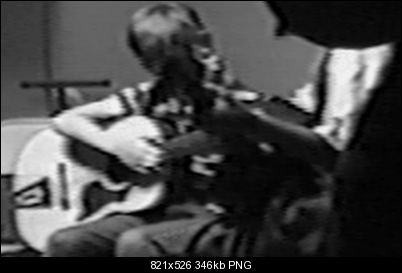

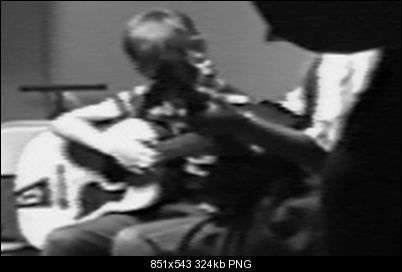

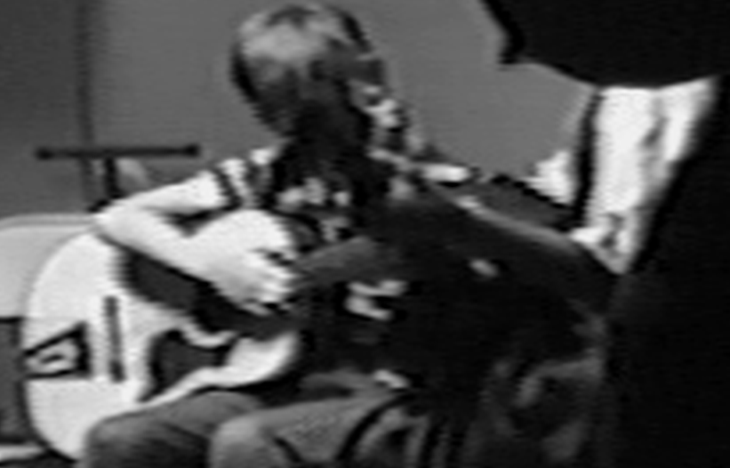

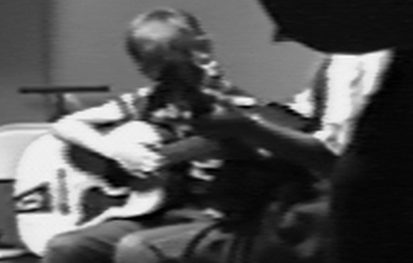

    I guess there's simply no way to prevent the JVC from flattening out bright areas. Sony vs JVC in greyscale, to show that it's a levels issue and not chroma:
ID:	23227Click image for larger version
    His hand becomes a solid object with the glowing guitar, even though the histogram shows no clipping.

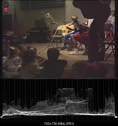

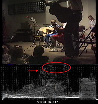

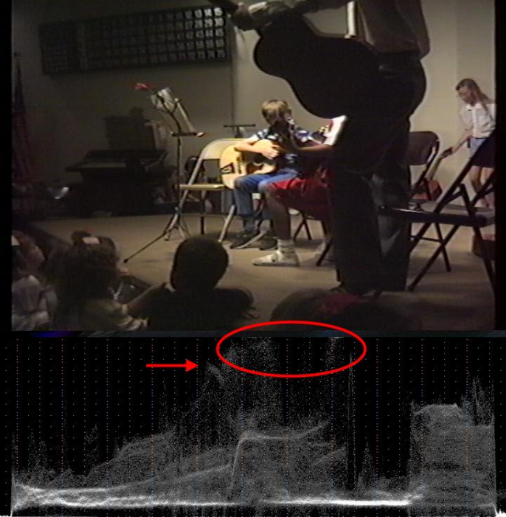

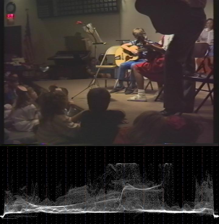

  12. Originally Posted by vaporeon800 View Post
    I guess there's simply no way to prevent the JVC from flattening out bright areas... His hand becomes a solid object with the glowing guitar, even though the histogram shows no clipping.
    Yes, when you look at a waveform monitor it becomes obvious the JVC has clipped all the peaks before final output. From the unprocessed videos:
    Sony:
    JVC:
    You can see that the circled peaks are crushed down the the level of the smaller peak to the left.
    I would look at the JVC's output with all its processing turned off. See if that makes any difference.
    Jan 2014
    Austin, TX
    Ok, will do. Worthwhile checking the Sony again with the adjusted proc amp settings?
  14. Originally Posted by dianedebuda View Post
    Yes, even the sony cap has crushed brights, and brights above IRE 100. The latter can be fixed in software but the former can't.

    I'd like to see a Sony capture with sharpness at the minimum setting and APC off. [EDIT: Haha, should have refreshed the page first.]

    Turning off the JVC's TBC seems to slightly recover the very brightest parts, but it's still doing it to almost the same degree.
    Sony doesn't have those washouts/blowouts, and VC500 retains all highlights while 550 still clips briefly. But the VC500's composite rainbowing is soooo awful and there seems to be luma detail loss also due to the comb filter.
    The 550, shockingly, seems to line TBC almost as well as the JVC itself while the VC500 is horizontally jittering all over the place.
    I don't see a reduction in haloing from Sony Sh2 to Sh1.
    Maybe it's best to take some amnesia pills so you forget all these artifacts you learned about and flip a coin to decide which to use.
    The earlier 550 captures, as I mentioned, did seem t have a subtely cleaner image -- I'm talking bout an overall impression, not 300% blowups and vectorscopes. In any case, do you notice that the darks in the VC500 look dense and grimy, but they're claner in the 550? I wonder if it has occurred to anyone that the VC500 is a darker image than the other card.
    Now you know why many users avoid JVC. Stick with the SONY. Note: all budget VCR's of all brands in all countries at all times under all circumstances have the defects you mention, and many of them are inherent to VHS and simply come with the territory. Pretty much the same can be said about above-budget VCR's as well, but it gets to be a matter of degree. Stay with the 550 for a while, but adjust levels during capture to prevent obvious problems. I don't think it has a TBC, but in any case you're better off with an older Panasonic or Toshiba DVD recorder used as a pass-thru tbc device; none of them create the etching, hard edges, digitally enhanced analog noise and color loss that comes with VHS->DV capture. But suit yourselves there; DV is lossy encoding regardless of high bitrates (lossy, per the dictionary, does not mean lossless), is designed for PC-only playback, has to be decoded to be processed properly for VHS cleanup, and will have to be re-encoded anyway for DVD or BluRay players and for many web applications.
