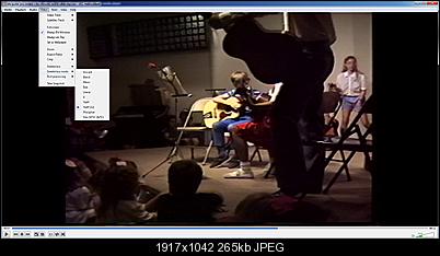

    I'll seach around the forum for examples of "aliasing", "motion noise" and "interlace problem".
    If it makes you feel any better, I have no idea what sanlyn is describing either. Could you post a picture, sanlyn?
    All frames shown here are fro0m interlaced video. All frames have motion. Apparently the O.P.'s camera doeswn't handle motion well, or maybe it's the cap devices. Probably poor interlace work in the cameras. I don't think it would be both cards, though. Left-click an image for full size display; these are full screen captures of playback with MPC-BE and VLC Player (latter has deint turned on).
    VLC Player (deinterlace turned on):
    [Attachment 23172 - Click to enlarge]
    MPC-BE:
    [Attachment 23173 - Click to enlarge]
    VLC Player - Live Telecast, SD-DVD cap - has motion on both sides of frame.
    [Attachment 23174 - Click to enlarge]
    MPC-BE - interlaced newsfilm - figures and camera in motion- HD PVR
    [Attachment 23175 - Click to enlarge]
    The s-video cable seems to be softening everything.

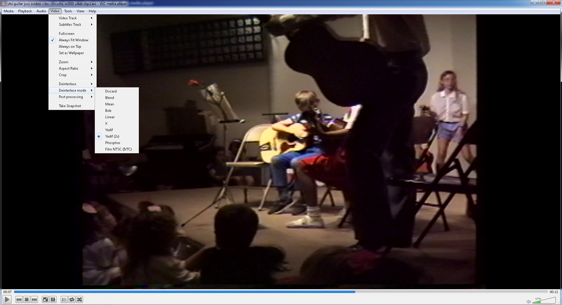

    Your other examples are video formats that your graphics card's hardware deinterlacer can handle, not YUY2 AVIs.
    Here is VLC deinterlacing it:
  22. Originally Posted by sanlyn View Post
    Thank goodness none of my stuff plays like that every time something moves.
    The OP's videos are interlaced video in a container/codec that's not flagging it as interlaced. Just turn on the player's deinterlacer if you don't want to see comb artifacts. If the OP's goal is to make DVDs she can simply encode them interlaced and let the DVD player or TV handle the deinterlacing. If she wants to upload to Youtube she can deinterlace before encoding.
  23. Banned
    New York, US
    If you set VLC Player's interlace dialog windows to "on", I believe that means it's "on". I don't know that MPC-BE has an on/off button for it, but I'm not going to fish out 30 interlaced and telecined videos to make the point that now and then we encounter crap from consumer cameras that makes me glad I never gave in to the temptation to buy one. The two "OK" captures (one from a DVD in my DVD drive, the other unaltered from my HD PVR video) were made with the same player settings used for the O.P.'s clips, and have no display problems. One of the noisy caps was from the original YUY2 capture with ffdshow's huff enabled (I believe huffyuv was in use there? Why don't other huffyuv videos have ragged edges on my players or PC's?). I have plenty of YUY2 Lagarith and huffyuv videos around that don't play that way. Anyway, I just checked the clips on one of my other PC's that has a different card, and a laptop that has yet another card. I made the progressive mkv's because I got tired of looking at the noise.
    The image above in post #52 has ragged edges, just not as many in that particular frame. But VLC player won't play YUV huffyuv or Lagarith YUV videos, so I don't know how that image was made with VLC Player. The VLC player image I posted had been converted to RGB so I could play it in VLC. The two noisy images were made thus:
    - VLC Player: Clip converted to Lagarith RGB.
    - MPC-BE: Original YUY2 clip with ffdshow's huffyuv enabled -- otherwise, it was scrambled with whatever version of huffyuv the O.P. is using.
    When I work on these captures I have to fast-recompress them with ffdfshow's huff to Lagarith YUY2. None of them will otherwise display properly on any of my PC's using the O.P.'s version of huff. I think it was mentioned that the "CCE Patch" version of huff was used. There was more than one version of that patched deal which were issued to handle a compatibility problem with huff and CCE encoders. I have a CCE patched version myself for my captures, which works OK on the capture PC but not on other machines where I have the same version installed (I have to open them in Avisynth and compress to Lagarith to avoid problems). What causes that is a mystery to me. But none of my captures have ragged edges on playback and I've been capturing that way since 2002.
    There are a couple of other threads with similar caps that have even worse problems on playback.
    Have you played them using ffdshow's Huffyuv as you did this one?
    Yadif isn't perfect. None of the frames look like yours; yours looks interlaced.
    The screenshot that I posted is from the original file, using VLC 2.0.8. What it won't do is display BFF videos in the correct order when bobbing is used.
