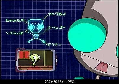

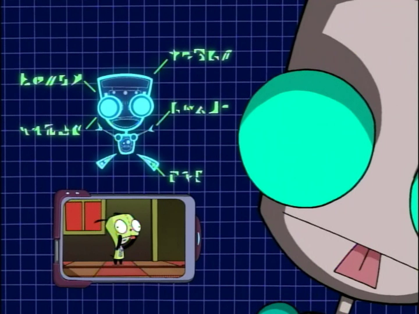

  6. Here's an example of a cartoon:
    Original DVD:

    What your typical upscaling player might look like:

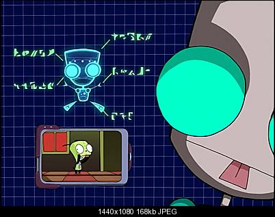

    What a good software upscaled video might look like:
    The first image was filtered and upscaled with LanczosResize() in AviSynth. The second upscaled image was upscaled with a few passes of nnedi3_rpow2(), aWarpSharp2(), Sharpen(), and Toon().
