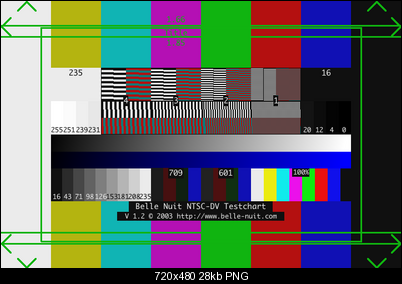

  5. But I don't know why you're comparing PAL and NTSC this way. Once you start resizing you're changing the video. So you can no longer compare directly.
    For example, try resizing this 720x480 frame to 720x576 using any resizing filter you want. Watch the thin horizontal lines in the "1" area.

  6. Originally Posted by jagabo View Post
    You are right to ask because I falsely stated what two videos I want to compare...
