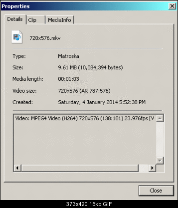

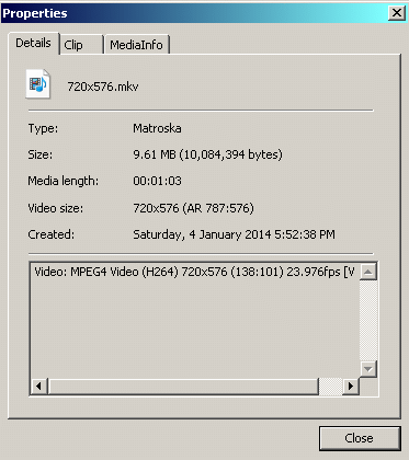

  10. I tried it again hello_hello, and no matter what I do (either in the script or in the preview window) I can't get Megui to encode a 720x576 4:3 video after cropping the black bars. It always encodes in 5:4 DAR, and the video becomes stretched. (Even if I put global MeGUI_darx = 4 AND global MeGUI_dary = 3)
    The only way I found to solve this, was to force sar inside x264 to 12:11
    Maybe if I tried something else in the script for darx and dary???

    I can't imagine what you're doing wrong. If anamorphic encoding is enabled it works for me every single time.
    Are you certain the SAR in the x264 encoder configuration is set to "Default"? If you are.....
    Run a short encode and switch to the Log tab. Right click on the log file to save it and then copy and paste the contents here. The log file includes the script used, the command line, and the aspect ratio etc. Hopefully it'll indicate what's going wrong.
    Or take a look at this one and compare it to yours. It's an encode of the sample you uploaded. I used anamorphic encoding and cropped to remove the crud and to keep the display aspect ratio the same. The Input DAR in the script creator was set to "ITU 4:3 NTSC". There's no need to crop extra if you don't want to, it's just the way I'd do it, but if you apply the same cropping as I did, the end result should be the same. If not, the DAR/SAR will be a little different depending on how you crop. I manually changed the resizing in the script to 720x576. Before encoding I opened the x264 encoder configuration and loaded the defaults. I've highlighted the important bits. The script is in blue, the resolution, DAR and SAR bits are in red. The only time the resolution and aspect ratio should be the same is if the log file shows "using SAR=1/1".
    --[Information] Log for job1 (video, 720x576.avs -> 720x576.mkv)
    --[Information] [05/01/14 4:52:41 AM] Started handling job
    --[Information] [05/01/14 4:52:41 AM] Preprocessing
    --[Information] [05/01/14 4:52:41 AM] Avisynth input script
    ---[NoImage] # Set DAR in encoder to 6480 : 4739. The following line is for automatic signalling
    ---[NoImage] global MeGUI_darx = 6480
    ---[NoImage] global MeGUI_dary = 4739
    ---[NoImage] LoadPlugin("C:\Program Files\MeGUI\tools\dgindex\DGDecode.dll")
    ---[NoImage] DGDecode_mpeg2source("D:\VTS_01_1.VOB.12.d2v")
    ---[NoImage] LoadPlugin("C:\Program Files\MeGUI\tools\avisynth_plugin\TIVTC.dll")
    ---[NoImage] tfm(order=-1).tdecimate(mode=1)
    ---[NoImage] crop(16, 4, -8, -12)
    ---[NoImage] Spline36Resize(720,576) # Spline36 (Neutral)
    --[Information] [05/01/14 4:52:41 AM] resolution: 720x576
    --[Information] [05/01/14 4:52:41 AM] frame rate: 24000/1001
    --[Information] [05/01/14 4:52:41 AM] aspect ratio: 6480:4739 (1.367)
    --[Information] [05/01/14 4:52:41 AM] Job commandline: "C:\Program Files\MeGUI\tools\x264\x264.exe" --keyint 240 --sar 5184:4739 --output "D:\720x576.mkv" "D:\720x576.avs"
    --[Information] [05/01/14 4:52:42 AM] Process started

  23. @ hello_hello:
    I don't get this at all if I follow your instructions:
    Instead, I get this in the "avs script creator" after I enable "anamorphic" - "resize to selected mod" AND change the "resize" field to anything, as you suggested (no cropping):
    # Set DAR in encoder to 67 : 49. The following line is for automatic signalling
    global MeGUI_darx = 67
    global MeGUI_dary = 49
    Note: Megui finds the "input DAR" to be "ITU 4:3 NTSC"

  26. Ok, hello_hello, I think you had mentioned this 0% acceptable aspect ratio a few posts back. I'll change it to 0% and let you know if it's ok later today.
    Thank you for the great MPC-HC "properties" way of seeing the DAR & SAR of a video!!!! This will help me a lot
    I'll change the "colour correction" and "upsizing allowed" settings too. I was searching for these settings too (but couldn't find any) to change them anyway!

  27. Originally Posted by provato View Post
    I don't really get though, what the difference between ITU 4:3 and 4:3 is....
    "ITU" is the "official" DVD resizing method but not all DVDs seem to use it. There's no way to tell for sure which method was used, although sometimes you can find a spot in the video where there's a direct-on shot of something which must be round and then compare resizing methods to see which way it looks round. Aside from that.....
    The ITU resizing method isn't exactly 4:3 or 16:9. I think it's always a little wider. The difference isn't huge.... something like 2.5%. As a "rule of thumb" (mine at least, don't hold me to anything) if a DVD has more than around 8 pixels of black bars down each side of the picture (or more than a total of 16 if they're uneven) it most likely uses ITU resizing. If the picture extends to the end of the frame (very small black bars at the sides or none at all) it probably requires exact 4:3 or 16:9 resizing. Pretty much all 4:3 DVDs are ITU. Old 16:9 DVDs are more likely to be ITU. Most newer 16:9 DVDs tend to be non-ITU.
    If memory serves me correctly I think ITU resizing assumes only 704 pixels of the width is actual picture, but it's resized to 4:3 or 16:9 (so 704x480 or 704x576 becomes 4:3 or 16:9). Therefore when resizing the entire 720 width the same way, the DAR ends up being a little wider than 4:3 or 16:9.
    You can over-ride the Input DAR MeGUI uses by changing it manually (ie change "ITU 16:9" to "16:9" etc). There's a setting in MeGUI's options to tell it whether or not to default to ITU resizing. Most programs let you choose one resize method or the other. Handbrake tries to be clever. I'm pretty sure it uses non-ITU resizing until the cropping exceeds a total of 14 pixels from the sides, then it switches to ITU resizing, but I don't think you can over-ride the Input DAR manually.
    If I open the same file for reencoding in MeGUI (your second method to see the correct AR), the "avs script creator" shows:Input DAR: ITU 4:3 PAL (1.367521)
    I'm fairly sure this is the exception to the rule..... MeGUI is getting it wrong. Why.......
    MeGUI uses MediaInfo to determine the aspect ratio (far more accurately than MediaInfo displays it when your viewing a file with it), but something like this is happening......
    MediaInfo says "this is a video with a 720x576 resolution and a 4:3 aspect ratio" and MeGUI decides "that's PAL" (ie DVD video etc). It's not PAL as such, although it could be, but MeGUI treats it as though it is and opens it using the DAR specified in settings. ie "ITU" in this case.
    If you go into MeGUI's settings and uncheck "Use ITU Aspect ratio" MeGUI will default to opening PAL/NTSC video using straight 4:3 or 16:9 resizing. I'd be willing to bet if you uncheck it and open the encode with MeGUI again, this time MeGUI will display "4:3 (1.333333)" as the aspect ratio.
    It's just one of those things..... if the resolution was anything other than 720x480 or 720x576, and probably if the aspect ratio was anything other than 4:3 or 16:9....... there wouldn't be any guessing as to the resizing.
    MPC-HC always uses 4:3 or 16:9 for PAL and NTSC. No ITU resizing in sight. In this case that just happened to be correct......
