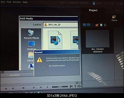

  16. Hi Again! It's odd, because when I put the clip presets into Premier, it keeps telling me to choose AVCHD 720 inststead of the DSLR presets. And, here's another big dilemma. I've been fooling around editing this evening in Premier Elements 10 again. Which I've surprised myself by learning quite handily. However, things are acting squirrely this evening. After viewing and snipping a clip in the Preview Monitor and then going to close it. It moves over into the Big Monitor, but only partially--like it's underlapped under there. I cleaned up my files today so that my computer would be running better, but this is really bugging me. Is it a problem with memory, or do I need to defrag again? We just did that last week. Click image for larger version
  17. what's happening is that every time I preview something or open anything and then try to close it, it gets stuck in the Big Preview Monitor on the top left. Then, it just freezes up. Maybe reboot the computer?
  18. Originally Posted by racer-x View Post
    I'm going under the assumption that you are editing the native MOV clips directly in Elements and are watching the playback from the timeline via the preview window......
    If this is true, then it is very likely your computer is overwhelmed by the processing power required for playback + transitions/filters added. More CPU and RAM would help here, but all should be fine when you finally render it all out. That is assuming your computer has enough power to watch the finished video format.
