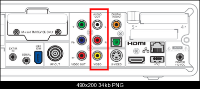

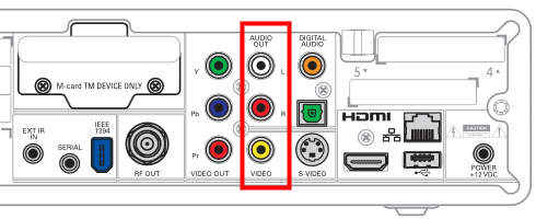

  5. Use the red/white RCA for audio, yellow RCA for video, with a standard A/V cable:
    For better image quality use an s-video cable instead of the yellow composite cable (to the right of the composite output in the above diagram).
    http://www.amazon.com/RiteAV-Audio-Video-Cable-feet/dp/B000V0DY7U/
    http://www.amazon.com/feet-Gold-Plated-S-Video-Cable/dp/B0002MQGK4/
    Be sure the recorder is set up to record from the correct inputs.
  6. Is the diagram the metrocast box or the magnavox box?
  7. I tried connecting it yesterday and I have a picture but no sound at all? Neep help
  8. The picture is from the DCX3200 manual -- which is the device you said you had. We know you need help. But we're not mind readers. Unless you tell us exactly what you tried we have no way of knowing what the problem is. What cables and inputs/outputs did you use.
