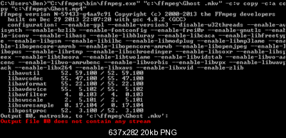

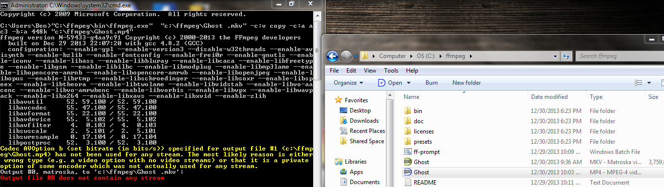

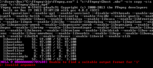

    I copied and pasted that command and it gave me this error

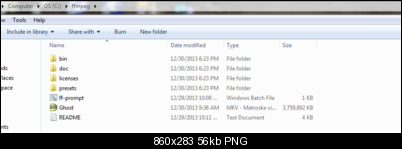

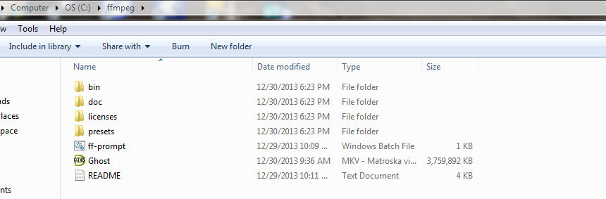

    what should i do? . The file is in the right directory

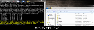

    So i re did the command and got this, what should i do ?

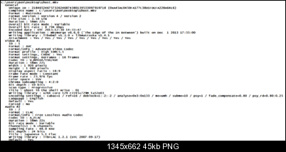

    I also took the information from the file from my video player and it has everything

  7. It should be "-i" without the quotes ; he's missing the "-"
    "C:\ffmpeg\bin\ffmpeg.exe" -i "c:\ffmpeg\Ghost .mkv" -c:v copy -c:a ac3 -b:a 448k "c:\ffmpeg\Ghost.mp4"

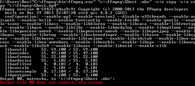

    It still says no stream .Click image for larger version
    ALAC works in .m4v or did you need .mp4 container
    Oh, is there a way to have the bit rate higher? the flac file was around 3500k. and will it be in 5.1 channel with the highest bit rate possible?
    Thank you !!!
    It is starting the process.
