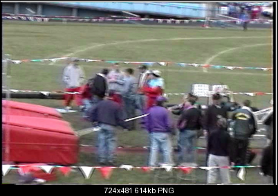

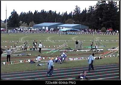

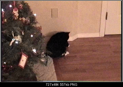

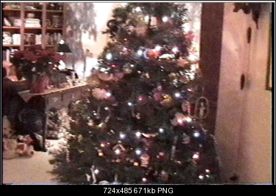

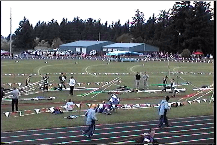

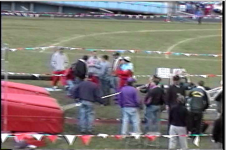

    It takes about 10 MB/sec when using the compression codecs above. The output looks good, same as what I see through the viewfinder. However, are there some filters that I should apply? It looks like some anti-aliasing filter would help. The video looks pretty grainy. Once I post-process, how do I burn to a DVD?

  10. Formerly 'vaporeon800' Brad's Avatar
    Apr 2001
    Vancouver, Canada
    VCM or DMO don't make any difference as far as quality or anything. DMO is the new DirectShow technology so it may perform .1% better.
    Not sure why you would use antialiasing. Are you unfamiliar with interlacing?
    I think people around here recommend AVStoDVD as a free DVD authoring app. Set it up to HCEnc. Paid software includes TMPGEnc Authoring Works etc.
