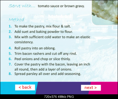

  1. He is trying to do a DVD in Pinnacle studio ultimate 15 but no matter what he does the images are terrible, he has learning difficulties so any help would be most appreciated thank you
Name:	poor quality.bmp

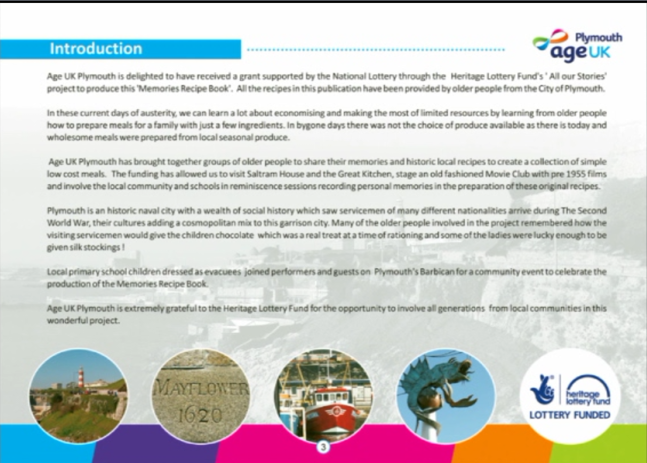

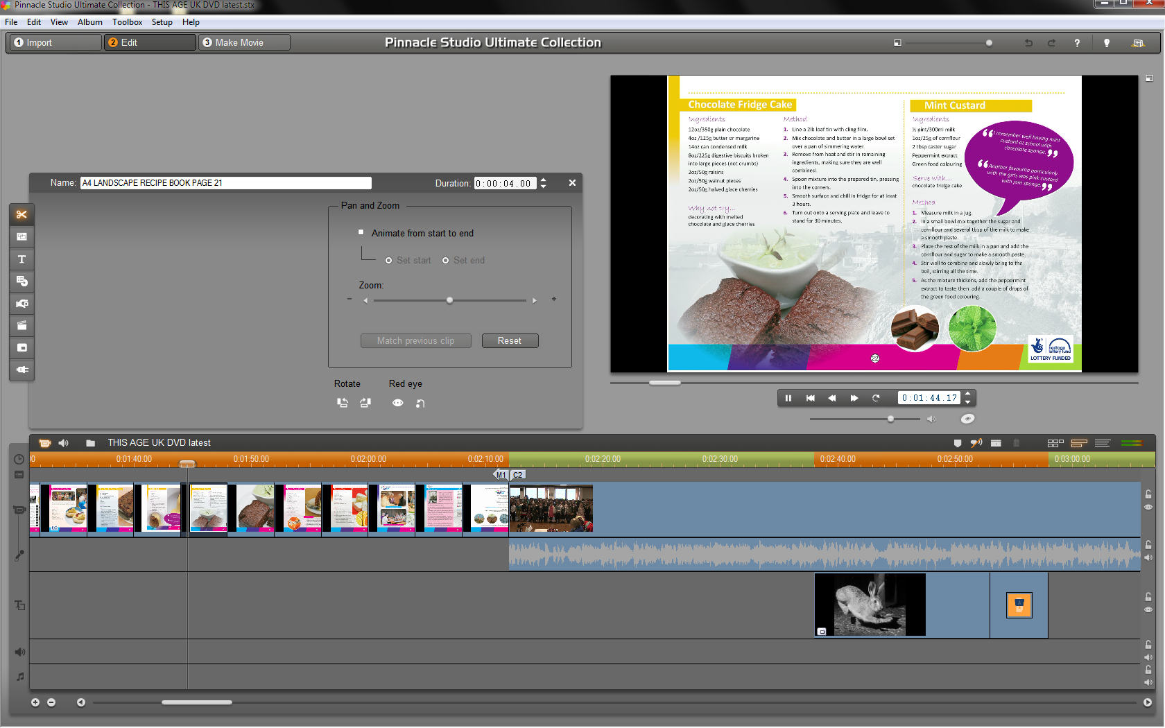

  2. I should have said that before rendering the bmp's look sharp, done as a standard pal dvd
  3. You can't have small text like that in standard definition video. There's simply not enough resolution. Use larger text.
  4. Cant use larger text it is a scan from a book, I did the dvd for him once and it came out perfect but have forgotten the settings, he has created the dvd with menus like shop bought when he does a hddvd it looks good but the menus don't work
  5. You are never going to get clear text of that size on a DVD. Using different resizing filters, sharpening filters, or cropping the page down may help a little. Or he can get the text here:

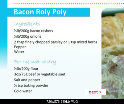

    The quality of the images IN the program are good but when finished they are poor see attached

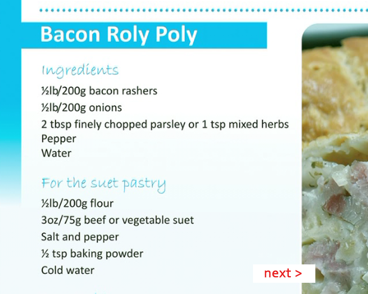

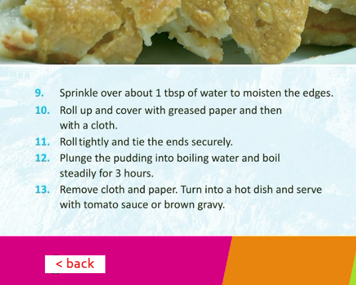

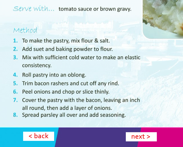

  14. edit: (cross-posted with your #13)
    It's a question of appropriate content for the medium. I would certainly read this on a tablet, a computer or even a phone.
    On a DVD, IMHO, I would at the very least break this down into at three pages of text. To do it properly for DVD, I would want, even expect, a live demonstration as well.
    quick page sample below:

  15. Most interesting and thank you for taking the time to make and show such a suggestion, hmmmmm, very interesting
