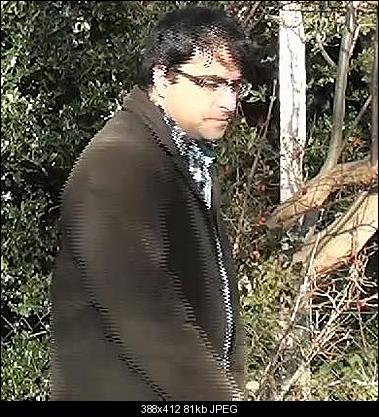

    I have captured some video off my sony 1080p camcorder and since my computer hasn't got the horse power to handle 1080p files, I have to alter them to 1280 x 720. I do this through tipard video converter, from which the result is fine. Now the problem appears when I input that file into womble mpeg editor and export it, the exported video has horizontal lines during movement. I have attached a sample of the output, can anyone help fix this?

    Secondly, the artifacts are very similar to the effect you see when interlaced material is improperly resized.

    1:1 crop from your 720p25 file:
    Never heard of Tipard. How about a sample or MediaInfo log of the original 1080p camcorder file?

    Thanks for the sample. It does appear to be interlaced, it is 1080i Vs. 1080p.
    and it can't be resized using "normal" methods".

    To see this artifact clearly, you should look at a sample that has steady movement - it shows up much better.
    In some cases, you may want to keep the interlacing, but for posting to youtube or similar,
    it can be (should be) de-interlaced.

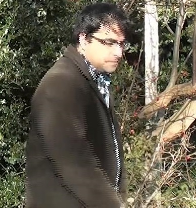

  12. It looks like 25i to me. 50 fields per second video packed as 25 interlaced frames per second. Converted to 720p50 (no audio)...

    Your 1080p camcorder recorded in 1080i50.
    You converted this to 720p25.
    Even if you got rid of the lines you would be throwing away half of the motion information present. Is this a video you want to actually use, or a workflow test?

    Perhaps the xilisoft deinterlaced the footage. Which model of Sony camera is it?
    We see this problem quite often in the forums, it always results when interlaced footage is resized
    without first deinterlacing in one way or another.
