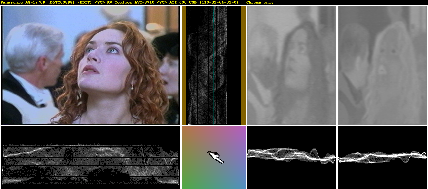

    I recently acquired an AVT-8710 and just went to try it with a copy-protected tape, only to find the contrast blooming astronomically. No such problems with the unprotected retail tapes I've played through it.
    I started with all of its internal proc amp controls reset, and then did brightness -1 and contrast -7 steps in an attempt to recover the levels. As you can see, this failed:

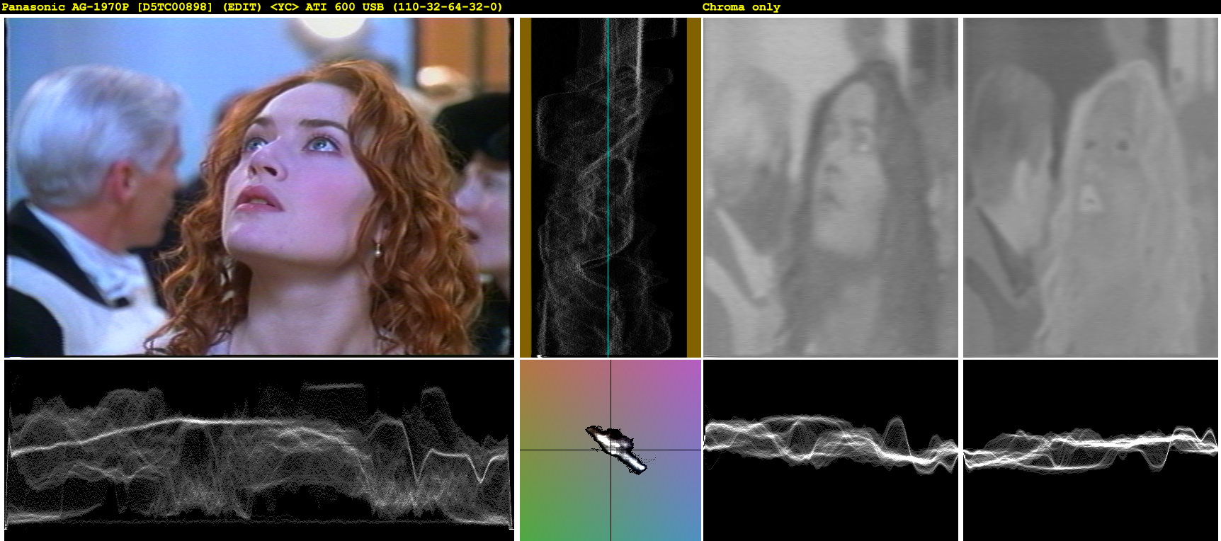

    Without the TBC in the chain, everything is well within limits of the ATI 600's default settings (but the Macrovision causes the driver to garble the video every few seconds).
