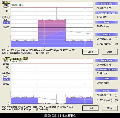

  8. I meant it looks ok in that comparing with vs. without the zone settings; the lower quality zone version had a smaller filesize with deteriorated zone...
    But it looks like the "quick" tests were too quick... It might be content related - I'm testing on noise clips - (e.g. a pure noise clip will behave differently than a smooth cartoon) but there seems to be an issue where only the 1st frame or few frames in the zone are really affected in crf mode (deteriorated, as expected by the higher crf value in the zone), not sure about the other rate control methods. I'll have a closer look later, but you're right something is amiss
  9. If you're doing a quick test I suggest you have 500 non-complex frames before and after the complex scene because I tried to do a quick test of encoding the rainy clip with crf18 but making all frames except first one a zone of crf40. It didn't work well, the clip ended up what you'd expect from using crf40 without a zone.
    This isn't that big of a deal now that I know to increase the quantizer a few notches higher than what I'd normally use but I thought I'd see if it's just me or if it's the norm.
    The only thing I do know is that the quantizer can't go from 18 to 40 right away but 4 quantizer notches per frame, so it takes about 6 frames for the quality of the zone to take effect but that is not relevant to this anomaly we've now seen. 12 frames don't make 1000 kb/s worth of differnece.

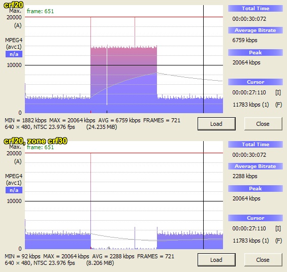

  11. Haha I feel stoopid LOL . I was going WTF, the bitrate graph is all screwed up
    It works ok. I'm 100% certain now . Stream analyzers, avg frame quantizers, bitrate graph all concur
    Post your megui log , perhaps your zone arguments aren't getting passed

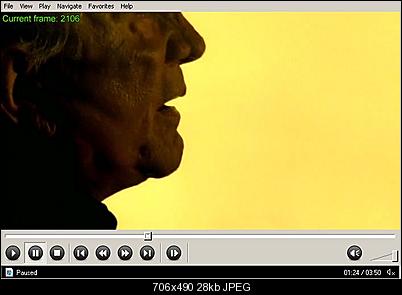

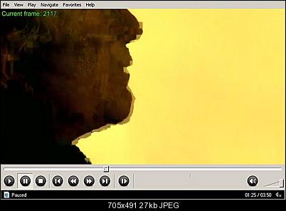

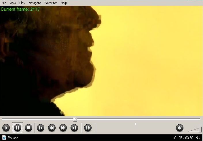

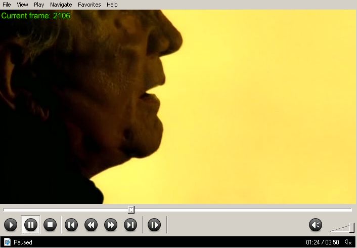

  15. I just test it again, it must be broken that feature somehow in Megui,or I do not know how to do it right, also possible:
    Megui: I used CRF 18 for video, and used zone: start frame 300, end frame 600, weight 200% (or other test with quantizer 10), Add, OK - after render it did nothing at all , both instances, comparing it to encode with no zones set
    X264: I used CRF 18: --zones 300,600,b=2 (or other test --zones 300,600,crf=10) - and it worked in both instances

  17. Ok I can confirm _Al_'s findings
    The x264.exe binary that comes with megui is fine (using zones with it via CL works).
    The log file says the --zones option is passed, but it clearly it's not affecting the encode when used via the GUI
    If you want to improve megui someone should file a bug report

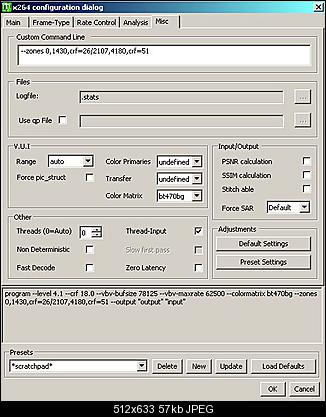

    Next encode after adding zones to the custom command line in the encoder configuration. Using a CRF value in zones seems to work that way.
    I added this:
    --zones 0,1430,crf=26/2107,4180,crf=51
    The log file says this:
    custom command line: --zones 0,1430,crf=26/2107,4180,crf=51
    --[Information] [28/12/13 6:35:48 PM] Job commandline: "C:\Program Files\MeGUI\tools\x264\x264.exe" --level 4.1 --crf 18.0 --vbv-bufsize 78125 --vbv-maxrate 62500 --colormatrix bt470bg
    --zones 0,1430,crf=26/2107,4180,crf=51 --sar 1:1 --output "D:\test.mkv" "D:\test.avs"

  22. I can confirm it works now through the GUI.
    The megui version I had was about a year old, so something got fixed. I suggest _Al_ to update it because it seems to work ok with all methods now: with the CLI (obviously), with the "extra commandline options", and with the "zones" button
    And yes, there are significant differences when using q= vs. crf= for the zone

  30. Excellent!
    For CRF to work in a zone when using 2 pass encoding you'd assume the encoder would need to run the usual 1st pass, decide how much bitrate the zone was going to require, subtract that from the total specified bitrate, then use what's left for the remainder of the video. I wonder if it'd need to encode the zone using CRF, or whether it can work it out just using a normal first pass. Or maybe 2 pass and CRF in zones just won't play nice together.....
