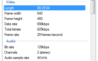

    Gosh, this is all very new to me. Ok, so the original recording details are as follows:
    I then selected 'Project' > 'Render As' > and rendered as various formats, such as MP4, WMV, AVI in Sony Movie Studio. (I think I may have 'upscaled' the conversion as you guys said??)
    How would I select the best Rendering option with the original video spec mentioned above?
