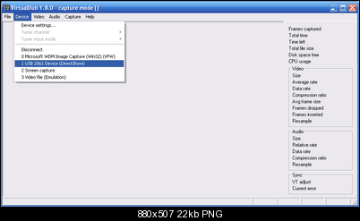

    Can I get you to try with VirtualDub again?
    File -> Capture AVI
    Then:
Name:	VirtualDub ezcap.tv.png
    As you can see, I don't get "OEM Device (Direct Show)" like you get. Mine shows the true chipset info. Did you install the ezcap.tv drivers correctly?
    Then go to Video->Video source and try the connection you're using whether it's S-Video or Composite to the ezcap.tv. Do you get a video signal?
    I've tried several applications that don't work as well (or work with problems). However, using VirtualDub for VHS is IMO the ultimate solution anyway and I would't care for any others. You won't go back once it works for you.

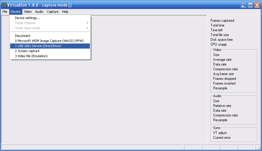

    But few minutes ago i went into virtualdub, and loook what the program told me;
    ^ It constantly claimed there were 25fps being shown, but all i saw was either those artifacts or a completely black screen.
    It's also worth noting that sound doesn't seem to work in VirtualDub, but in the honestech application it works flawlessly.
    So since i switched over to a completely new VCR recorder and the stick itself is brand new as well i assume this is still a drivers issue by the looks of it?
    Maybe the Ezcap i'm using is different from the "ezcap 116" drivers from the homepage? But then again, why don't the drivers that came with the CD itself work properly?

    Yes, try some different tapes from different sources as DB83 mentioned, but, regardless, if it doesn't say "USB 2861 Device", or similar, then the ezcap.tv is not installed correctly. It's that simple.
    Where did it get that "Grabber" stuff? That's wrong. It's obviously from the fake one. Also, it's not that the ezcap.tv is "worse" since the previous one didn't work anyway. I don't want to sound like a nag, and do want to help, but this is why we don't recommend such phony products here as they can mess up your system, and don't function correctly (just do a search and see - you are not alone). You may need to clean out your registry entries to properly install the ezcap.tv, or any other such device, now. Do you know how to do that?
