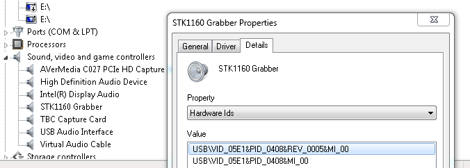

    I really think this is a driver issue. "OEM Device" is not the name included in the driver INF on their website. Apparently the hardware version called USBTV007 comes up as "OEM Device" for other people too, but not the STK1160 that LogiLink's drivers claim their device to be. But it could be that they are just packaging whatever stock they get from China without regard for whether it matches the original specs.
    What does Device Manager say about your current driver version and your device ID?

  19. What does Device Manager say about your current driver version and your device ID?
    It's not even listed as "STK1160" for me, and the ID's don't match those in your screenshot either...
    What I did not see discussed is the 'video source'. Have you clicked/opened up the options - the two cogs alongside the 'OEM Device' - and see what is there. You should see 'composite'
    I did that yes, the only thing listed in the related dropdown menu is "OEM Device" and nothing else. And i'm running the honestech application on composite mode of course.

    Okay well your USB device ID matches the USBTV007. Here is the driver link that the EasycapExpertti page suggests using. There is no installer; you have to "Update" the driver manually. Of course for all I know you are already using this version. If it still doesn't work, moving on to a better device sounds like the best option to me.

  23. Nope still no luck, it says "the drivers for this device are already up to date".
    There doesn't seem to be a way to override this message either by the looks of it...

  29. Well, the new ezcap stick arrived today...
    But unfortunately it still doesn't seem to work properly for me, neither on WinXP nor on Win7;
    As you can see here the application properly detected the signal itself (sound also worked during my first try), but the video preview feed itself is still empty. This is the case on both XP and Windows 7.
    ^ This is how the ezcap is connected while not delivering any video feed.
    I also used the male to male cable seen at the bottom right in this pic to try out all the other jacks on this device in conjunction with the ezcap, but to no avail.
    Note that i also followed the instructions on this manufacturer infopic down to the very last letter, and am still not getting any feed.
    Does *anyone* here know what i'm doing wrong? Jeez...
    Best regards
  30. Also, i'm getting a "Error: cannot run preview graph" when chosing "MPEG2" output in VideoView...
    edit: tried to capture an avi in VideoView, and it said it was recording frames of the VHS feed, but when i opened the avi (curiously enough it didn't save it as avi but just as a file without extension), windows media player was only showing a black video screen as well.
